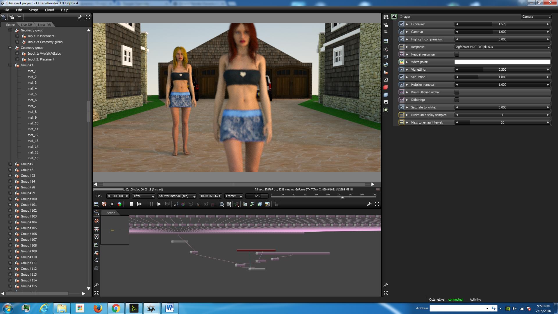

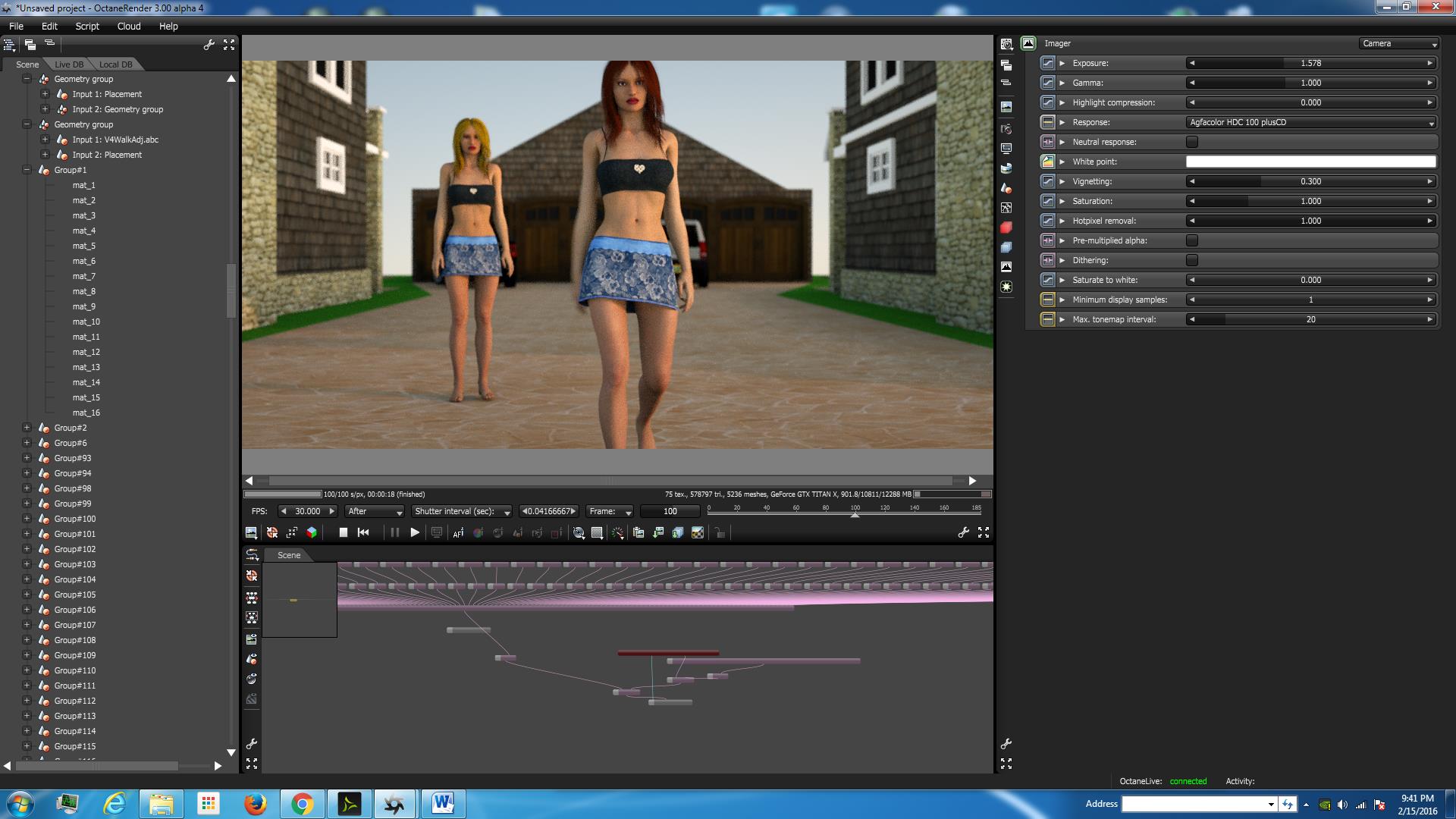

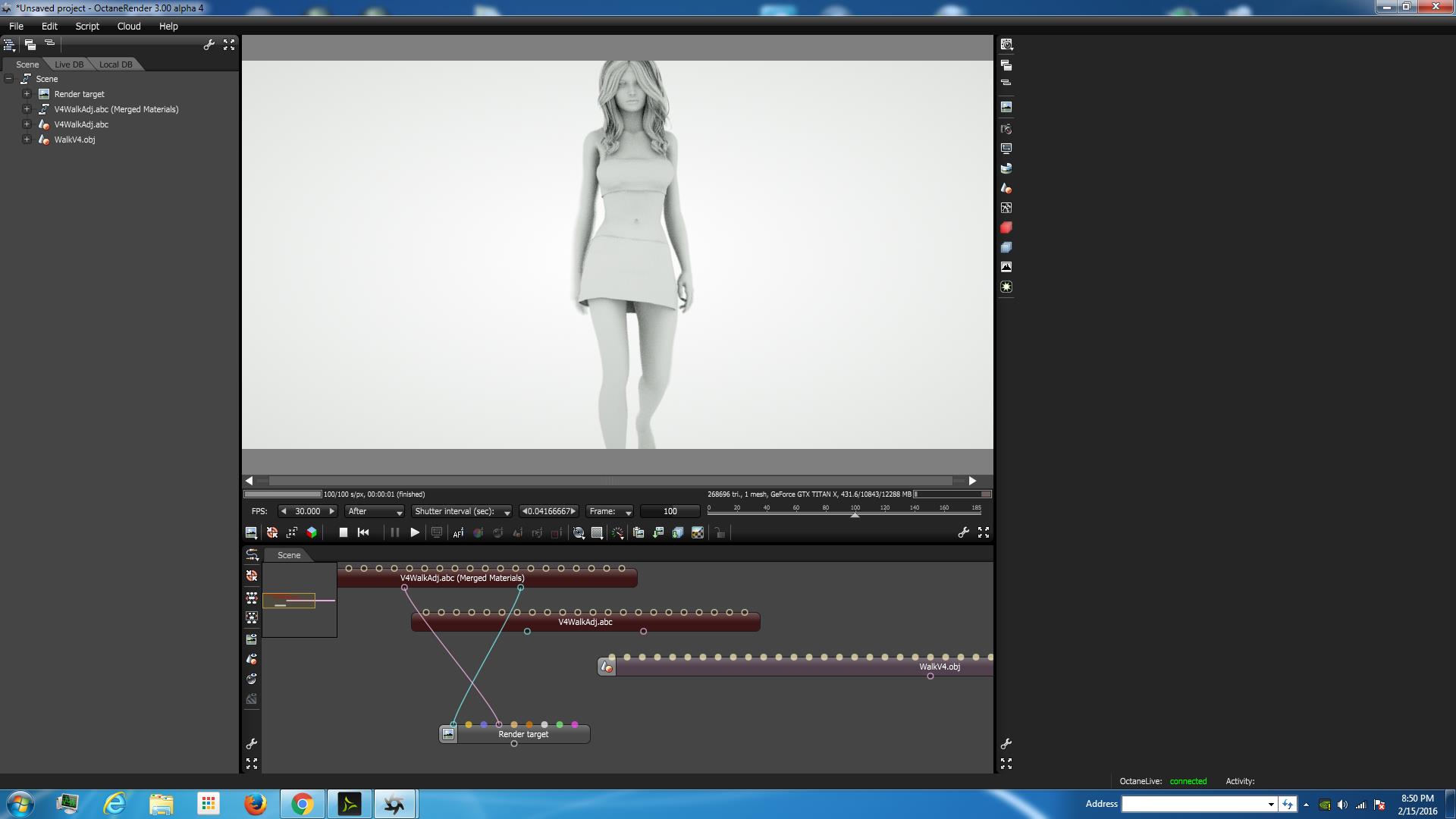

The script didn't seem to work here, even tried additional different node variations just to see what might happen, but no dice. I know it was just a try anyway, so thanks. The C4D zoom cam file actually was the really helpful thing ;)
Tried the script
Tried the script
My guess is that the ABC exporter from the DAZStudio plugin is only exporting camera position, target and up, and potentially not fov (but I might be wrong - try it for yourself). So you can zoom by moving the camera position in DAZStudio and that should get exported in the ABC file.
It defaults to what you set in Daz, and you cannot tweak the numeric camera parameters for focus, and the camera target cannot be changed unless you detach the abc cam node connector from the render target. However, it actually lets you select any geometry as a focus point beyond what it was imported to focus on , so for example I could select the girl in front, middle, or garage in back, and it would render out the scene with that focus continuously as the frames progress. Although, I had no focus change as part of the Alembic export itself from Daz. Had this been the case, I don't know what the result is yet. Nevertheless, cool!
Chose garage in back as focus point
Frames continued to be rendered with focus on garage in back

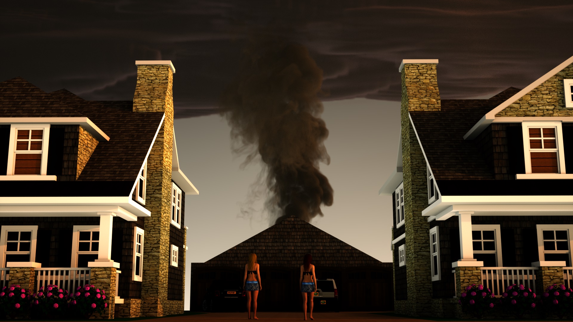

And just for the heck of it...
Look out, VDBnado!
Look out, VDBnado!
