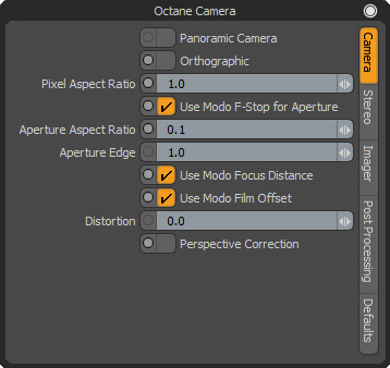

Near Clip Depth missing from Octane Camera?

...using build OctaneRender_for_Modo901_2_25_0_95_64bit on Modo 902.

I just did a fresh install of OctaneRender_for_Modo901_2_25_0_95_64bit and Near Clip Depth is present in the Octane Camera panel. I suggest deleting your Modo902.cfg file and trying again.

Hey Paul, thanks mate. I figured out what the issue was. I had the octane clipping distance channel tied into the modo clipping distance channel which oddly causes the octane nearclipdistance to disappear in the octane camera option, rather then being visible but greyed out.
Not really an issue because I just use the modo clipping distance to adjust, it's just odd that it causes the field to disappear from the octane camera options.
