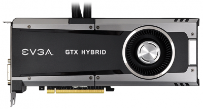

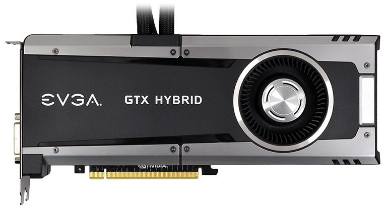

Finally yanked my two old ghetto water-cooled 580 3GBs and slapped a couple EVGA 980Ti Hybrids in...
Wow! Just did some test renders at full blast and neither one ever got above 49°! Might have to pull the 780Ti and get another or two of these bad-boys. Practically dead silent too.. even with the stock fans. I could have put my Corsair SP120 Quiets on the rads, but see no need, yet.
And FYI guys, the new EVGA Hybrids apparently now all ship with the kick-ass silver shroud -- like their face off program version -- where you could get this sweet shroud shipped to you for replacement. These pups are sexy! I was totally expecting those fugly shrouds, as shown in Amazon images... what a wonderful surprise!
Not that I have a side window, or look inside workstation much, but still real nice.
Gonna go fire up a game and test further!
