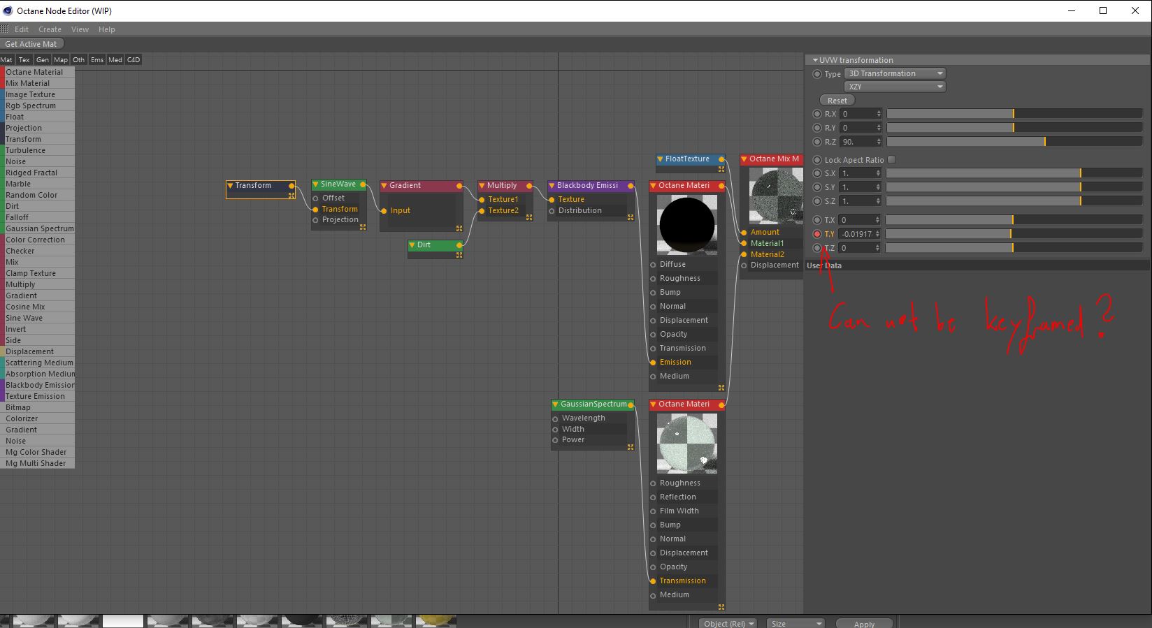

I have a gradient in sinewave mode applied in a shader as an emissive texture. Now I want to animate the gradient (offset). I tried to keyframe the T.X value in its transform node, but C4D is not registering any keyframed animation. Neither in the viewport nor in the attribute manager itself.
Any idea?

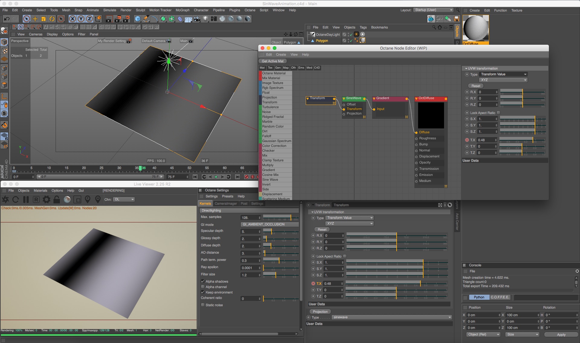

weird, here is working as expected, maybe something strange in mapping and or projection?

Projection and mapping are all set to UVW. Strange
