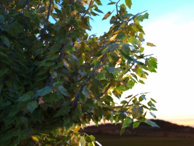

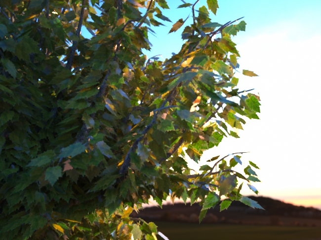

3dreamstudios wrote:Anyone have a method for creating a good leaf material? One that has some translucency when backlit from sun?
I have all the texture images etc....just don't know what nodes to try for the translucency, back lit part. Thanks.
p.s.
here some examples as stills...(click it for bigger resolution)
snip lwguru
