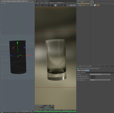

Am I missing something about getting smooth glass on an object that has wall thickness? It seems that you have to subdivide extremely high to not see any tessellation and even then it is still somewhat apparent. Is the solution to this something basic I am missing? I feel a little dumb but would love to find out what I'm missing here.
Did you check "Smooth" in the "Basic" tab of your glass material?

Double polys? Mesh not closed? Phong angle? Change "Subdivide UVs"? Did you try Check Mesh?
If the mesh is from a different program - does it consist of triangles that don't play well with Sub Divs?
Hard to say without a scene file ...

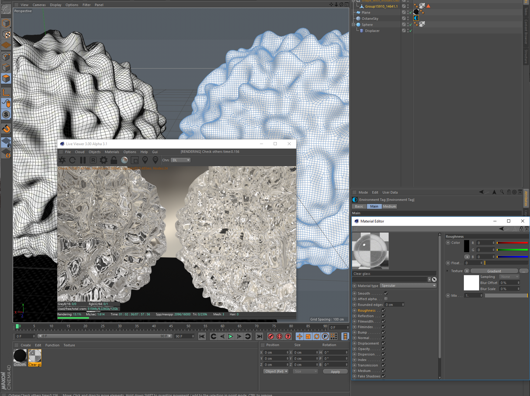

No problems here. Left one is the standard spec material created from the LV, right one is the fake falloff glass.
Lighting via HDRI environment.
Both are really low poly.

Thanks for the replies!
I knew it was going to be something simple I was over looking and I'm now pretty sure it was the smooth button. It didn't work at first but after a restart it smoothed everything out. I'll double check on my projects at home to but I think that was it. Argh, I feel dumb.
