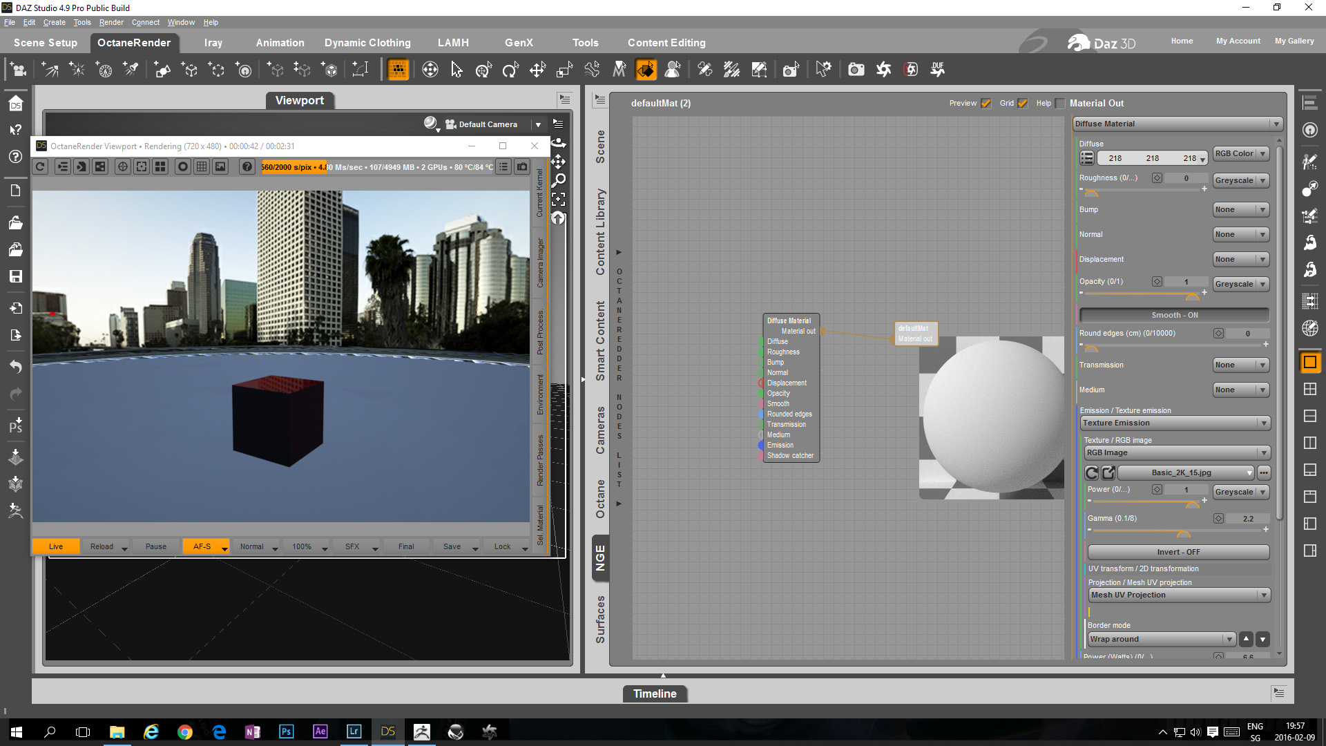

When I use an HDRI background and a plane as a shadow cathcher, can't figure out how to get the camera to keep the near background in focus and blur the stuff in the back ground. In iray it's simple i choose infinite sphere with ground and it works, can i do the same in octane?

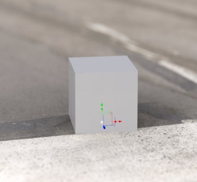

here's a sample render from iray, notice how the ground under the box is in focus and stuff in the distance is blurry.

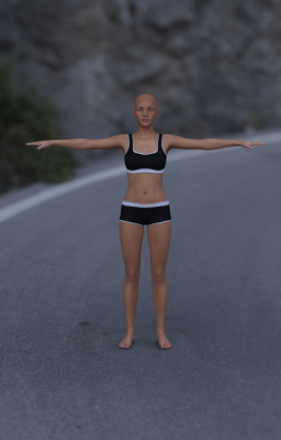

focus range on when using HDRI

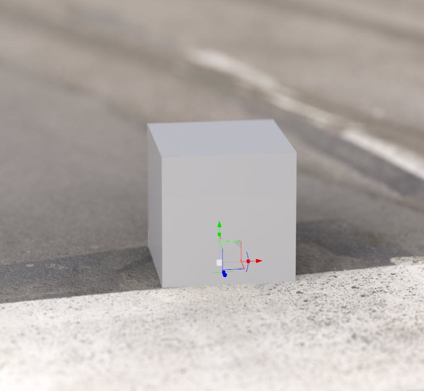

Sorry don;t understand, how do you change the thin lens aperture? is that the same as the regular aperture, if so, yes I know how to change that, and I do see the change in DOF, as you mentioned the backdrop is always out of focus, in Iray it looks like it wraps the background and create a ground object, so then things in the distance are blurry and things up close are in focus. maybe this example is more obvious

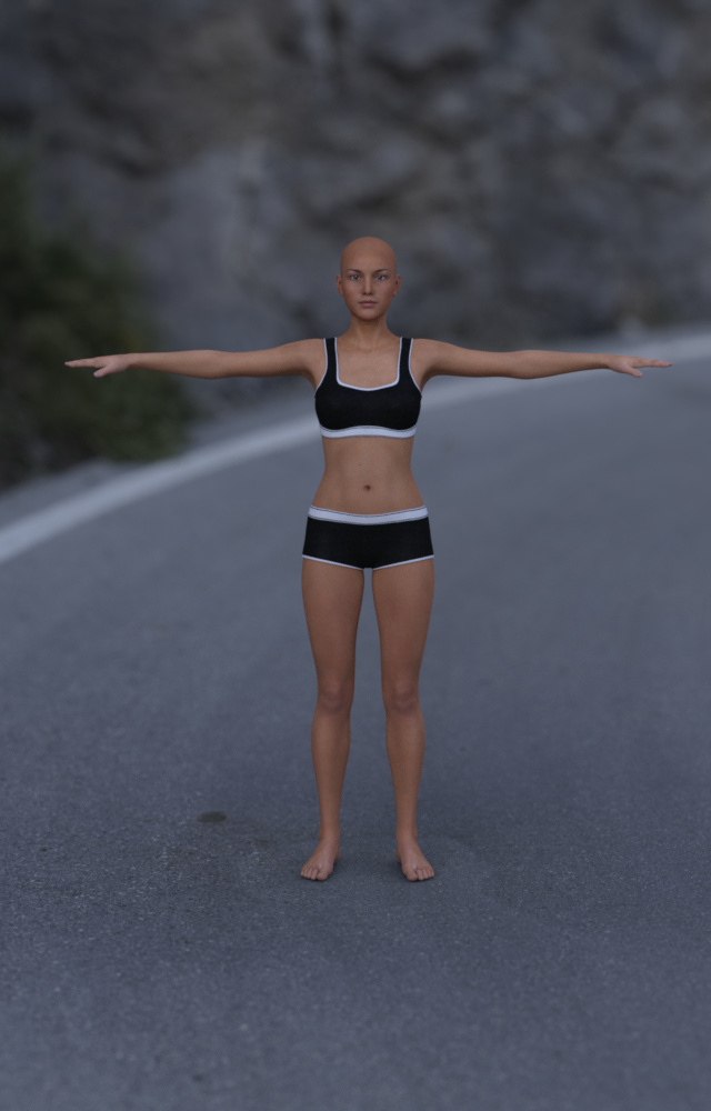

- the HDR background is a 360 degree sphere
- there is no way to indicate the distance between background sphere and camera
- there is by default no ground
Iray
- the HDR background is a dome
- you are able to indicate the distance to the background
- there is a ground
Background:
- the background part of the HDRI may be blurred the same way in both Iray and OR
not yet tested:
- in Iray the HDRI background depth of field may be calculated based on the indicated distance settings.
Floor:
because the Iray dome has
distance settings
a ground floor
depth of field may be applied to the floor part of the HDRI dome in Iray based on realistic calculations.

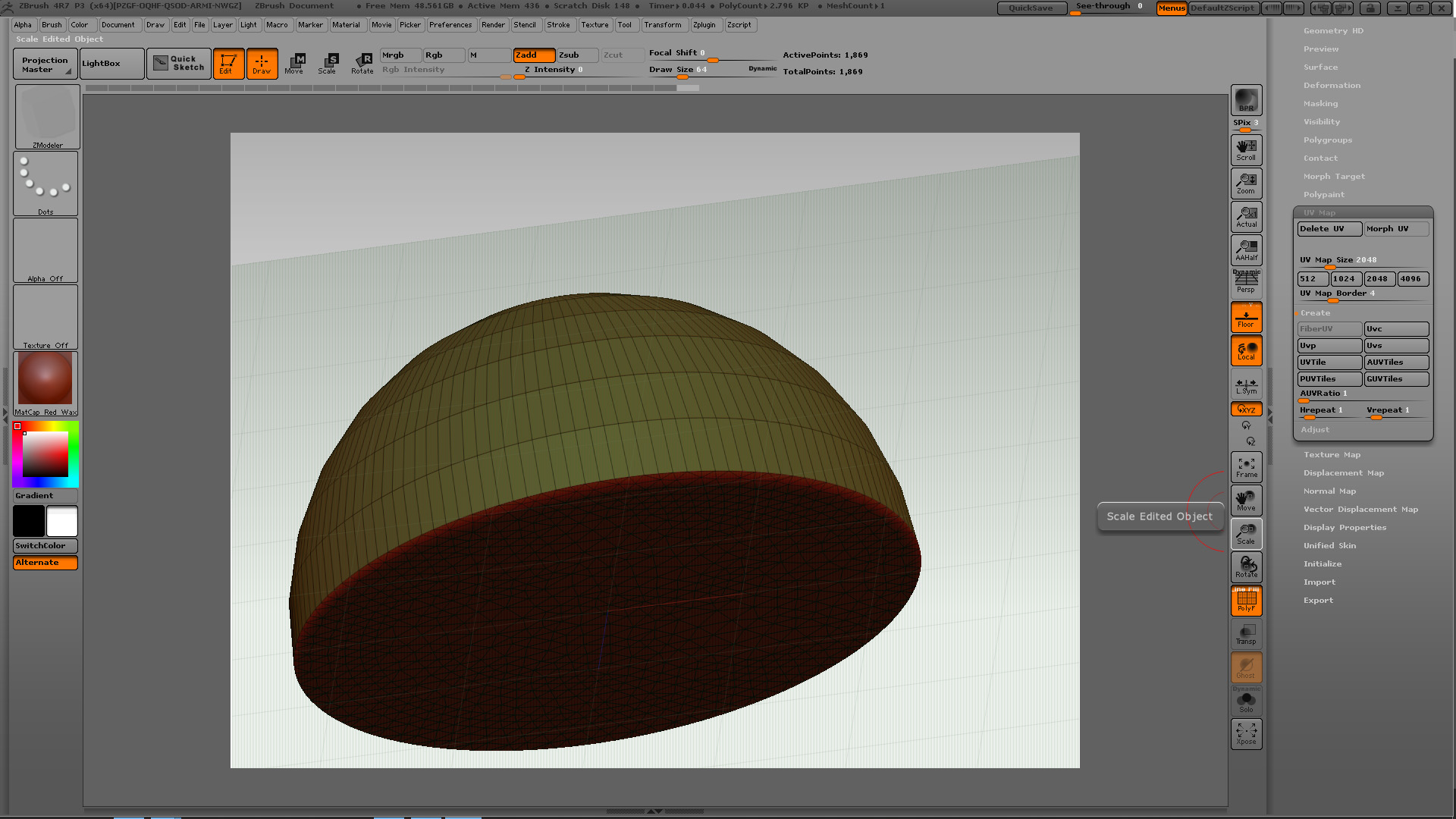

I did some tests but was so far not able to figure out a solution how to use a HDR image set up for a sphere to use on a dome with ground plane.
There was always distortion on the ground.
@ blackbody emission
If you are familiar with adjusting the proper power settings for the HDRI environment you can use a similar workflow to find the optimal settings for texture emission.
Using the HDRI environment seems much more intuitive though. I am still having issues finding the right balance of values when using texture emission with sky spheres or domes...
@ UV issues
It seems you have to use a dome with inverted normal facing inwards to see the texture.
You may also need to flip the V coordinate before exporting the dome from Zbrush to DAZ Studio.
I tried with experimenting with the following values
- the UV settings in Zbrush
- the "projection mode" in OctaneRender
Nevertheless I was not able to find a combination so it is possible to use a map that was created for a spherical UV and apply it to a dome with ground plane without getting the ground area distorted.
If someone wants to keep trying the updated .zip with a WIP dome .obj and two .ztl is added...

I think it's going to be hard without doing projection math of some kind.
If I undestand corretly, you need to show half of a spherial image on a plane. Maybe we could use methods from map making, there are several methods for such projections. I guess it should be possible to create a UV map that's based on such a projection?
With regards to the emission, remember that you can just use the "no shadows" trick on the environment sphere, and have a normal HDRI background shine through it.
