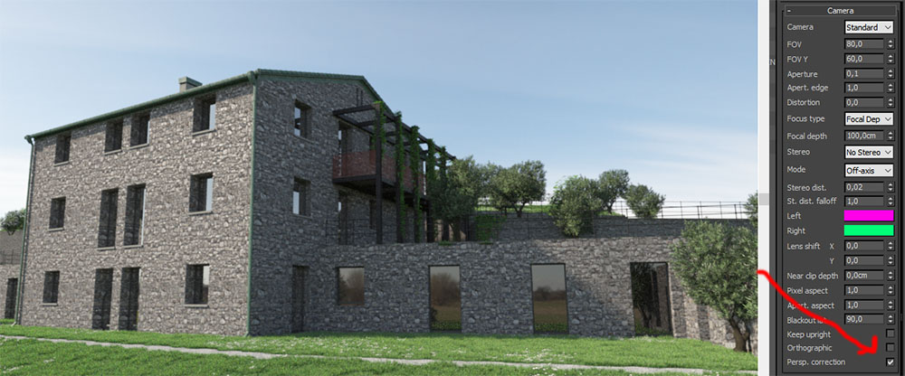

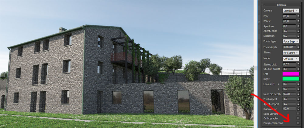

Excuse me, maybe I have not found the right answer to this problem..
But Why the perspective correction does not work ?
thanks

I'm still using v2.13 and I can now confirm that perspective correct, keep upright doesnt work.
It used to work as 1.19 that using max standard camera and applying a camera correction modifier. now that seems to be broken

I kind of find the better solution is to just a flat camera with Y offset in the camera parameters. I think it would be more geometrically accurate that the squeezing and crunching of the max perspective modifier. Just my 2c
