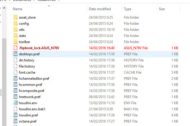

Moderator: juanjgon
I think that I have found the problem.
Please check your Houdini configuration folder ($HOME/houdini15). If the at some point in the past your MPlay application have crashed, sometimes it could leave in this folder a file named something like ".flipbook_lock.computer_name". Remove it and the MPlay should work again without problems.
-Juanjo
