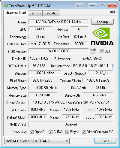

I'm currently running my 2X Titan X at 16x PCIe speed on my X99 mobo, and i was wondering how much the compiling time of the scene will increase on 8x speed, and if it will be linear? (e.g double the time)
So i prepared a sample "heavy" scene, on my machine (specs below) it took 1:07 minutes to compile the geometry (from the moment i hit the render target button till the moment the image appears)
I sent the scene over to Sebastian (smicha), we both thought the compiling time will be almost double since he running at 8x speed, but no! it was faster! Sebastian quote:
So opening the scene takes 7.5 seconds. When I hit render on render target it takes 54 seconds the image to appear. I have 4x 4.5GHz 2600k - 5 year old cpu. What I noticed in a task manager that around 25th second of compilation the cpu is stressed at 100% on all cores. So the CPU speed may affect the overall time. But your 5930k is 6 core and is faster at stock than my 4 core at 4.5ghz. I expected longer times at mine rig, not 15 seconds faster.
Some notes:
• Video attached with recording of my test
• i did the test on Octane 3.00 and on Octane 3.04 - same speed
• the orbx for the test could be found here: https://goo.gl/nrWqi0 so please feel free to do the same test on your machine
• screencap from GPU-Z attached for my PCIe 16x speed
• My machine didn't stress the CPU to 100% on the test while smicha machine does
Tutor, (Or any other member that running dual xeons) Would you mind to do this test please and post here what your compiling times? (If you confirms that cpu matters in loading geometry it will be a greatest move to go with dual cpus on my upcoming build)
Any thoughts?

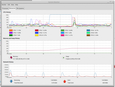

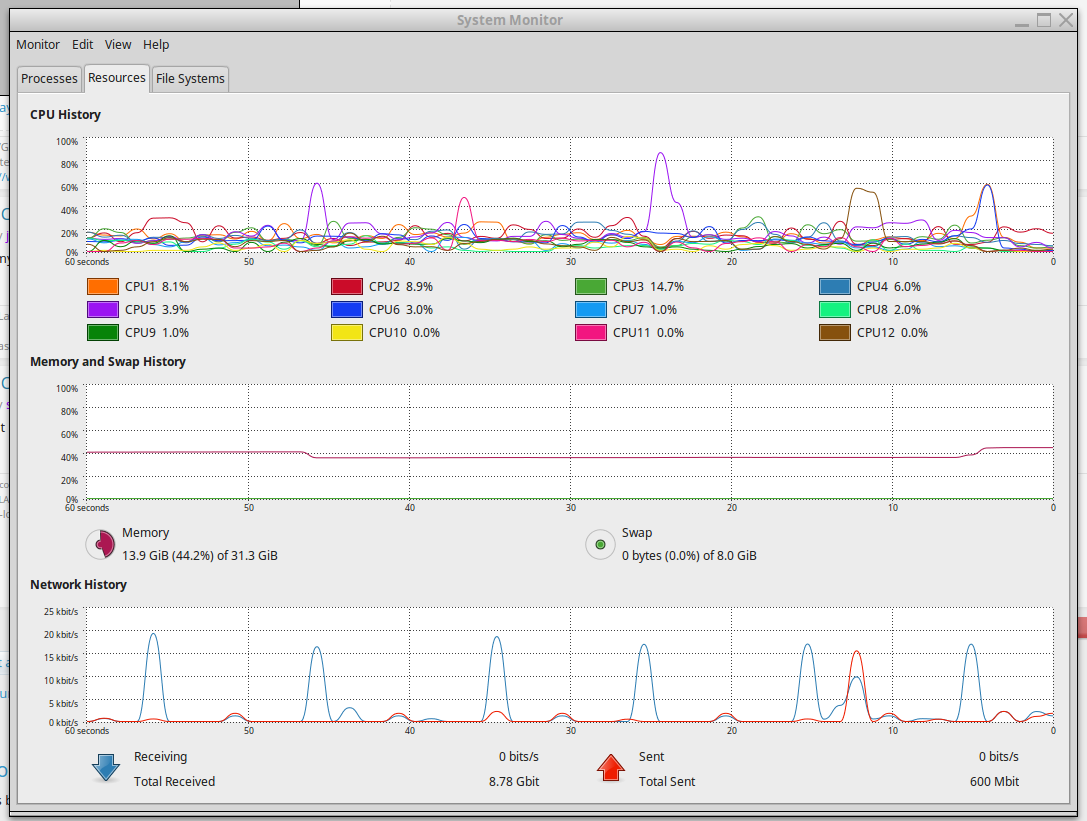

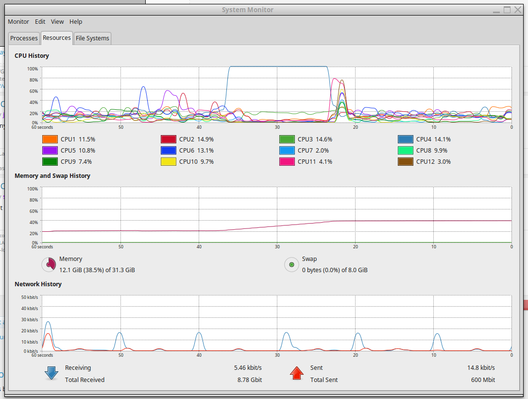

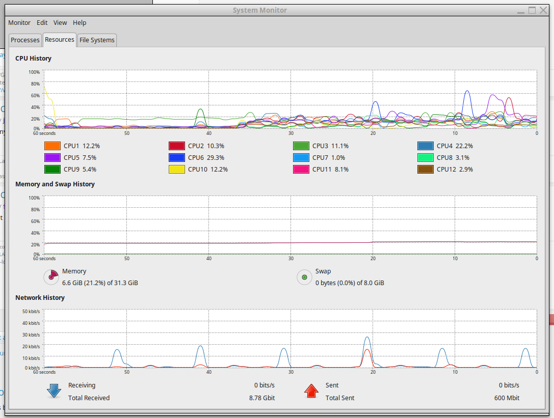

I took snapshots of my CPU usage as it compiled and rendered:
I didn't see the CPUs get very busy at all. There was that one spike for one cpu but it could have been something else. If it was CPU bound I think we would see a lot more load on the CPUs?

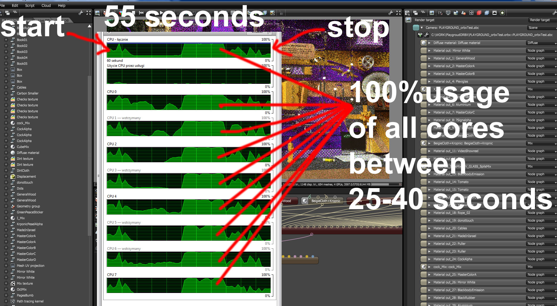

This topic becomes one the most important in terms of Octane performance, especially for those who animate tons of scenes and must recompile every frame. And the results are highly surprising. I think it is worth searching for true reasons what is causing such discrepancies in compilation time, even 4 times.
1. The most striking behavior is (besides it is all 8x on asus ws mobo) that my i7 2600k OC @4.5GHz and constant voltage 1.32V (all power settings in bios are maxed and power saving features are off ) is stressed between 25-40th seconds to 100% on all cores (CPU, not GPU!). If this matters (I read carefully what Tutor wrote) the max temp during compilation on all cores is 45-55C (CPU temp, not GPU - bear in mind that this is a watercooled machine). The overall time of compilation is 55 seconds which compared:
to yam - 18% faster (but yam's GPUs are at 16x, on 5930k at 3.7GHz on 6 cores) and comparing core clocks 4.5/3.7 gives 21% of difference - but this is not consistent - read further on
to pegot - 2.7x faster (same cards as mine 780 6GB, 4 cores @3.5GHz, i7 3770k) - comparing clocks mine shall be 28% faster, but is 170% faster.
to grimm - 3.75x faster (probably due to 4GB of vram on 980 - the scene takes around 3.6GB, cpu is 5820k- 6 core @3.8GHZ) - do you have OOC texture on ?
to jayroth - 10% faster (I assumed it was 1 minute) but jayroth has 20 cores on dual 2687 at 3.1GHz (is it under load?) and 16x gpus
2. At grimm's diagrams we don't see all cpu activity during over 3 minute period of compilation so it's hard to say what is going on during compilation
3. Looking at Yam's cpu activity it is stressed only to 70% at 30-40th sec.
4. jayroth - I meant CPU activity, not GPU
5. Tutor insights are important - I'll try do down-clock my cpu to e.g. 3GHz and see the difference.
OTOY - please take a look at these numbers. This may impact the way we build our machines and the way Octane is coded.
BTW. I run win 7 and 3.04
