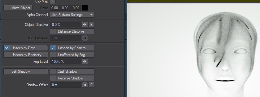

Before when I enabled FibreFx, the hair have been rendered as Octane Hair.
Now I can't reproduce it was rendered. Please see the attached file.

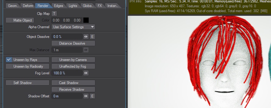

You can't see the hairs because you have the "Unseen by camera" flag enabled in the guides object. This flag is enabled by FiberFX when you use hair guides objects, so you must remember to disable it.
-Juanjo

I did not noticed the point.
Now I can get a correct image!
