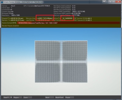

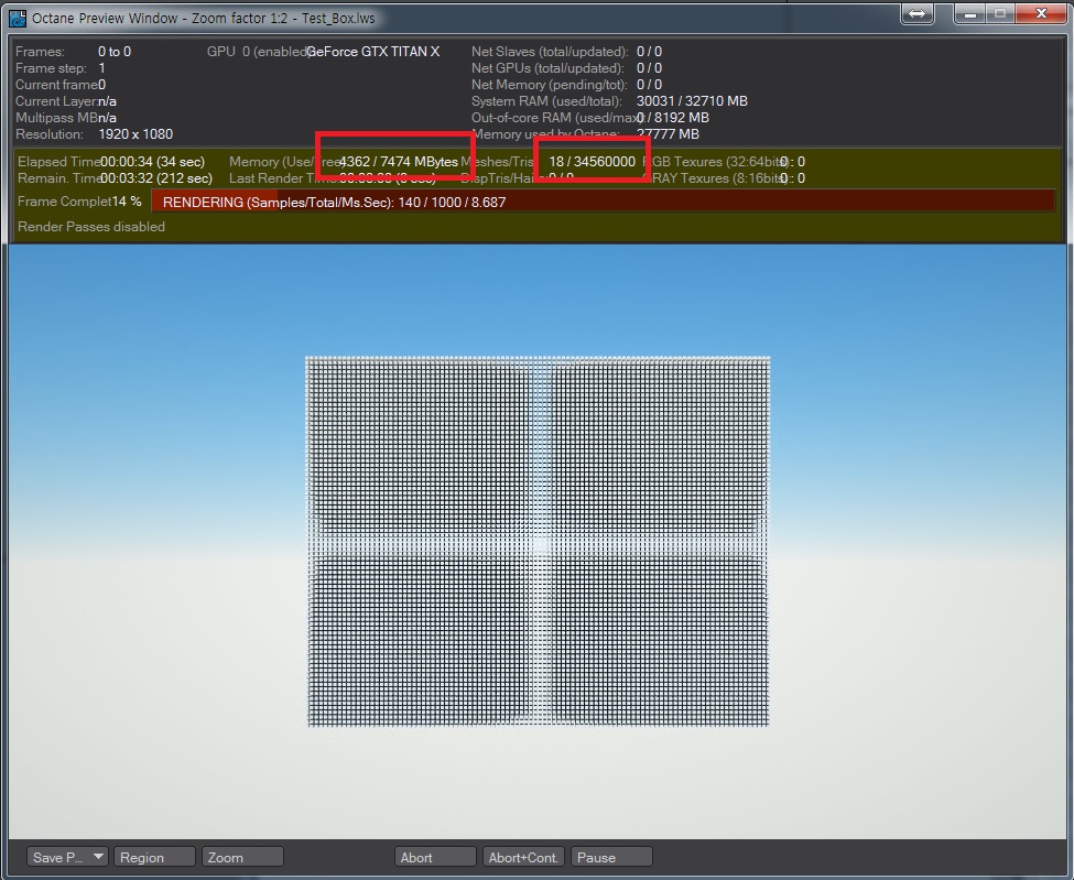

1.024M * 37 Triangle Render Pass 37.888M
1.024M * 38 Triangle Render Error 38.912M Titan X *3
1.024M * 38 Triangle Render Pass & Error 38.912M Titan X *1
00:02:33 (0153.25) | <> Mem Used/Free/Total: 5405 / 6394 / 12288
00:02:33 (0153.25) | <> Triangles/DisplaceTris/Hairs/Objects/Voxels rendered: 38912000 / 0 / 0 / 38 / 0
00:02:33 (0153.25) | <> Textures RGB32/RGB64/GREY8/GREY16 used: 0 / 0 / 0 / 0
00:02:33 (0153.25) | ... Init rendering ...
00:02:50 (0170.26) * OCTANE API MSG: CUDA error 719 on device 2: An exception occurred on the device while executing a kernel. The context cannot be used anymore and must be destroyed. All existing device memory allocations from this context are invalid and must be reconstructed.
00:02:50 (0170.26) * OCTANE API MSG: -> kernel execution failed (report)
00:02:50 (0170.26) * OCTANE API MSG: -> failed to launch kernel (ptBrdf2)
00:02:50 (0170.26) * OCTANE API MSG: device 2: direct light kernel failed

How many times we've tested, whether there is a problem in more than 38 million Triangle, it is difficult to determine whether an error in the memory more than 5.5GB.
However, the heavy Scene contained in the texture of the Triangle 20 million and an error occurs.
After all it seems the problem is memory.
Or do not properly support the Titan X ...
