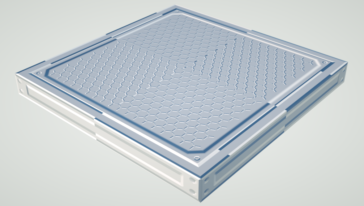

This is a bit of a longshot, but I have been getting annoyed by a normal map related bug in Octane, and I was wondering if it could be corrected from within the Modo plugin. Normal maps assigned to mirrored UVs render inverted. I am working on a scene that started as a real-time environment, and so utilizes lots of mirroring and such. Is there any way for the Modo Octane plugin to detect and correct/compensate for this error? Or is this a non-trivial issue that would be better to push for a fix in the Octane render engine?

Octane render normal map mirrored UVs bug

Thanks for sending the scene through. I can now reproduce the problem. I will need to submit it to Otoy for further analysis. I will post here once I know more.

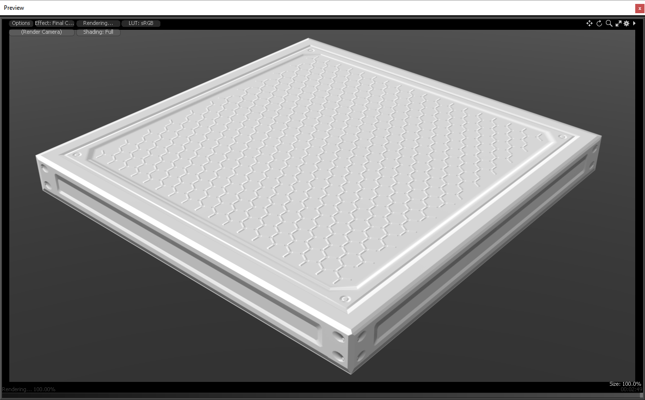

Awesome! Thanks, Paul. I also sent you a Modo internal renderer shot with colorspace set to none in the image properties so you can see how it should look.
Mirrored normal map rendered correctly in Modo internal render engine.

I can reproduce this problem. And if the normal map is plugged into the diffuse pin it renders correctly - so the UV's are fine. I have sent the scene to Otoy who have had a look. I will ask them to provide an explanation of the issue, since it's over my head.

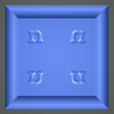

Let's for example use a simple normal map:
Normal map example
Normal map example

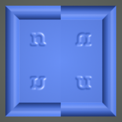

And render it on a square with mirrored UV coordinates in the 4 quadrants:
Note that although you only see one seam, the normal map is wrong in the upper right and lower left quadrant. Note the orientation of the highlights on the mirrored n.

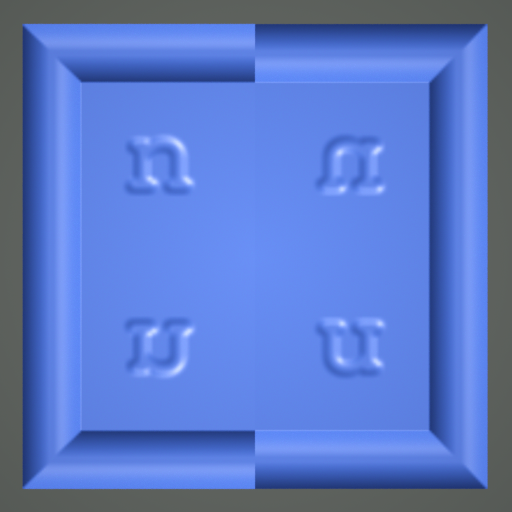

Using just the usual UV mapping on a plane and relying on our mirror border mode for textures doesn't result in edges, but it still results in wrong orientations because the normal map distortion still needs to be mirrored in the right and bottom parts of the quad (note the bottom border).
We are at the moment not planning to implement this kind of mirroring in Octane. The only way right now is to convert this normal map into a bigger normal map covering all 4 quadrants (and applying the right mirroring). Is this a common use case?
