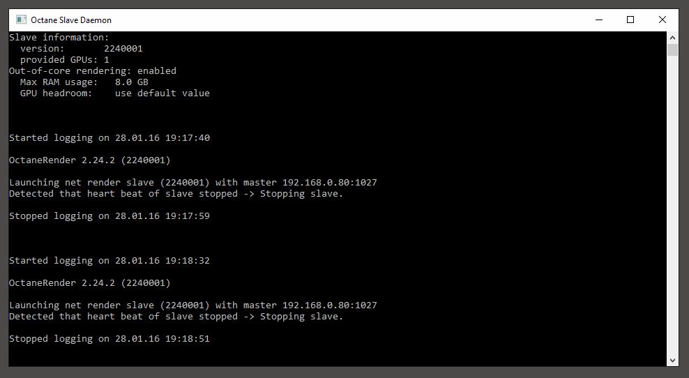

Im running into massive problems rendering on/with any of our slaves.
I'm trying to render a maya scene which is about 1GB via network attached slaves.
Everything worked fine until yesterday. When it says: Detected that heart beat of slave stopped -> Stopping Slave
I read something that a huhe HDRI environment can lead to this kind of problems. (I'm using a 16.000x8.000px HDRI)
The Master System is a MacPro (Win) Titan X 12GB / 64GB Mem. Slaves are:
Amd 7850k + 2x 780 3Gb / 16 GB Mem.
Amd 8320 + 1x 780ti 3Gb / 16 GB Mem.
i7 4770K + 3x 780ti 3GB / 32 GB Mem.
We're using Standalone/Plugin 2.24.2
Any Ideas? Thank you so much guys!
