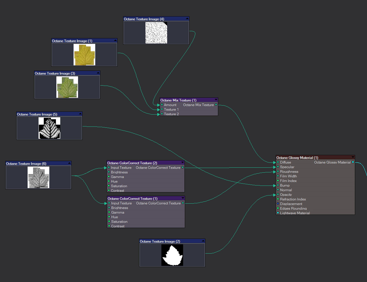

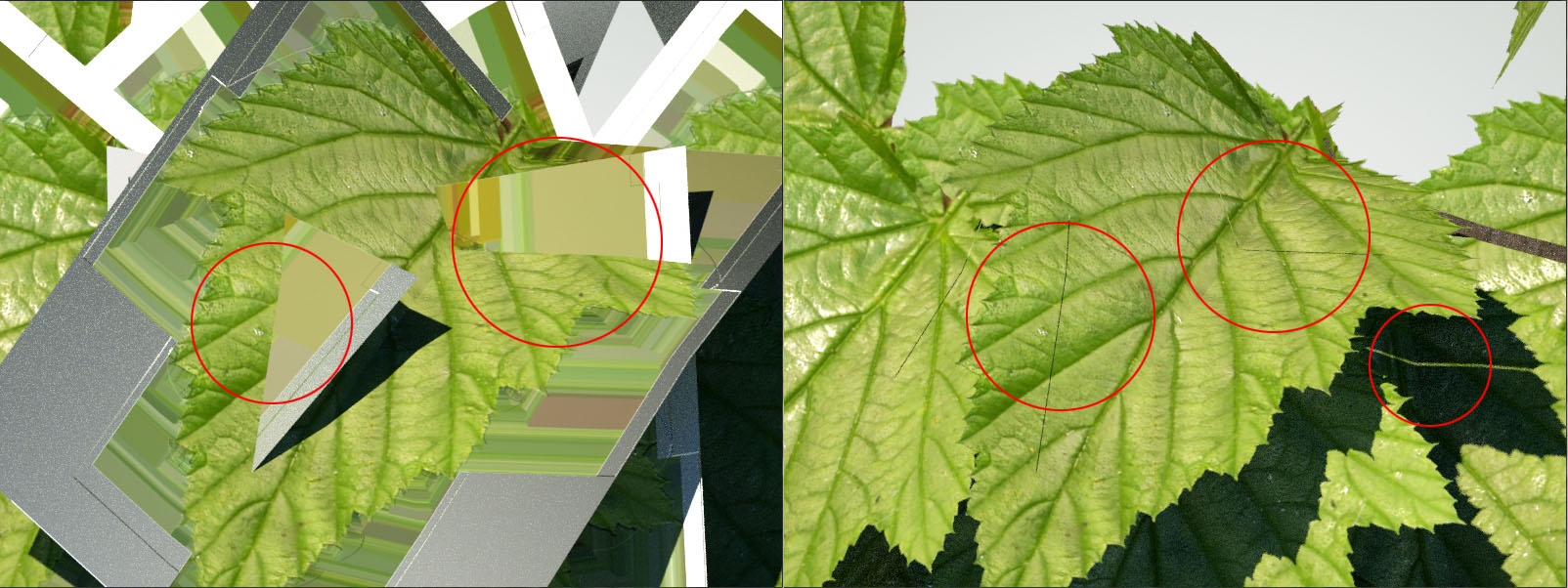

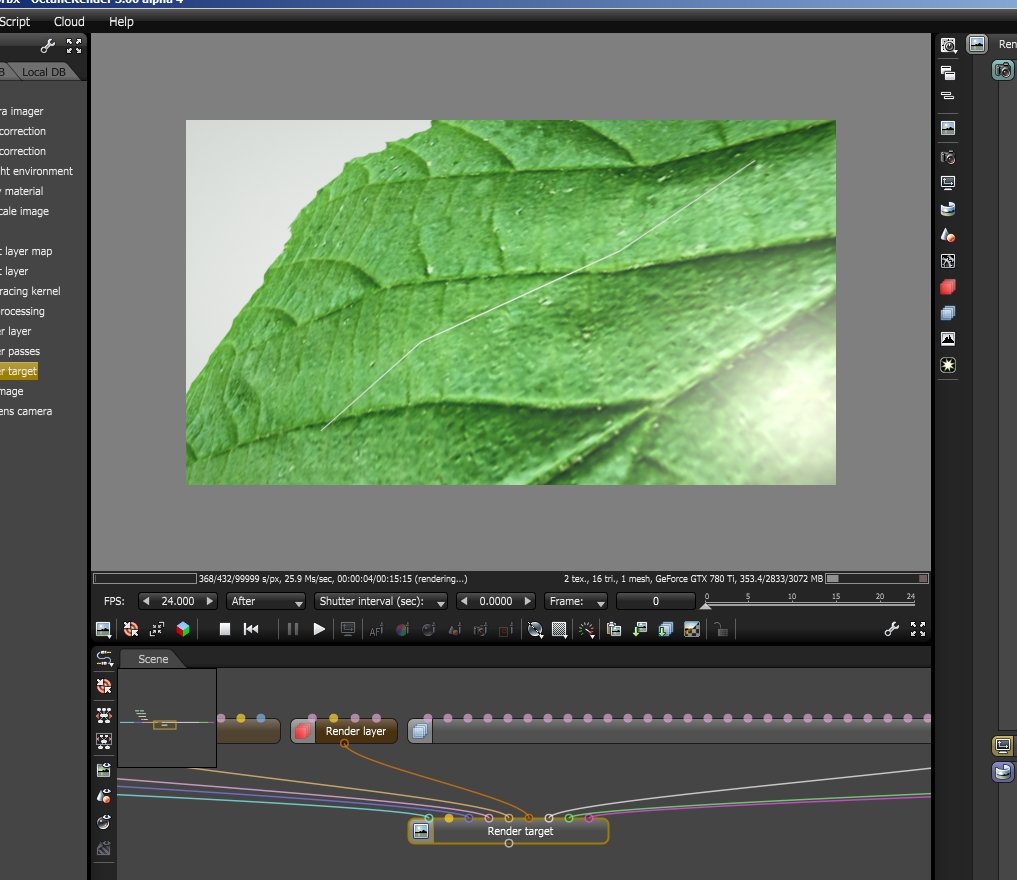

Lightwave 11.6 + Octane 3.0Beta
Polygon Opacity Map Problem
The map is transparent polygons and lines caused the meeting point
Test.zip
(1.34 MiB) Downloaded 168 times
juanjgon
Posts: 8867
Location: Spain
Thanks, I can reproduce this problem here, even in the Standalone. It seems an issue in the Octane engine. I will report it to the dev. team.
-Juanjo

Hey guys,
You can get rid of those artifacts by reducing your kernel's ray epsilon until they are not visible anymore.
We can investigate how to avoid this in the future.
Thank you.
