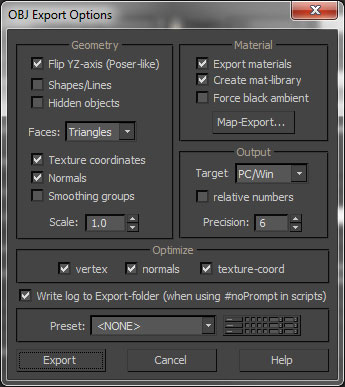

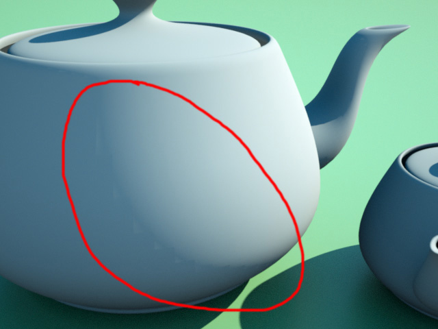

When I import a scene from 3DMax and assign to the objects an octane diffuse material and use the daylight system I get some weird artifacts close to the shadows.
I tried every combination of export option from max (with and without the 3dMax plugin) as well as connected the smooth parameter on the Octane material but nothing works.
I think it only happens with the diffuse material and daylight system, or at least its when its more noticable.
Is this some kind of bug or just an error on my side?

I will attach a file with a picture of the artifacts and a screen grab of my export settings.

It's the "terminator problem". You can solve it (only) by subdividing the mesh, so that the artifacts become smaller.

So I can only solve this issue by subdividing the mesh.... good to know.

Koke wrote:When I import a scene from 3DMax and assign to the objects an octane diffuse material and use the daylight system I get some weird artifacts close to the shadows.
I use Blender, and I have found that you need to smooth the object in BOTH the modeling software AND Octane. If you only apply smoothing in Octane, then jagged edges can show up.
