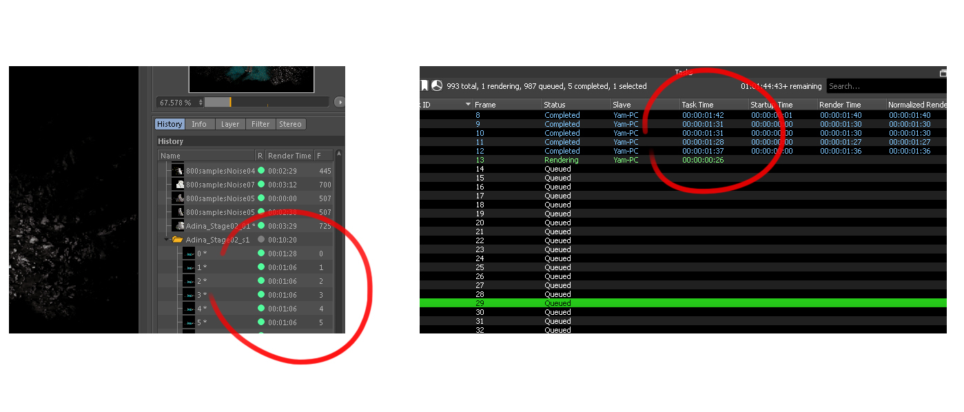

I just understand then while rendering with Thinkbox Deadline (command line actually) the render is slower then picture viewer (few seconds for each frame)
Please find attached screenshots for rendertimes in picture viewer vs same render in Deadline. As you can see each frame rendering with deadline is longer.
What could be the reason for that? Maybe the render the collecting geometry every frame?

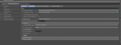

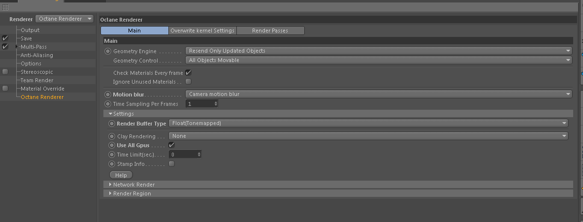

Deadline Log for a frame & octane render settings also attached,

I think it reload all data for every frames. Plugin has complex algorithms to detect just changed parts of scenes.
Yeah it's reloading all data every frame, and it sucks! If i'm giving more frames per task (10 for example) - it will reload all data each 10 frames, but it cause other problems.

Best way to use render queue with Octane Network render option. So plugin will not spend extra time on geometry re-uploading for every frames.
You can fine-tune the scene in Maya plugin manually so that it only reloads the needed geometry during animation rendering and does not spend the time on not moved/deformed geometry. If it is done properly it can improve the overall rendering speed dramatically.vhannon wrote:We have had the same issue using Maya+Octane ...
https://docs.otoy.com/#56Mesh%20geometry%20types
