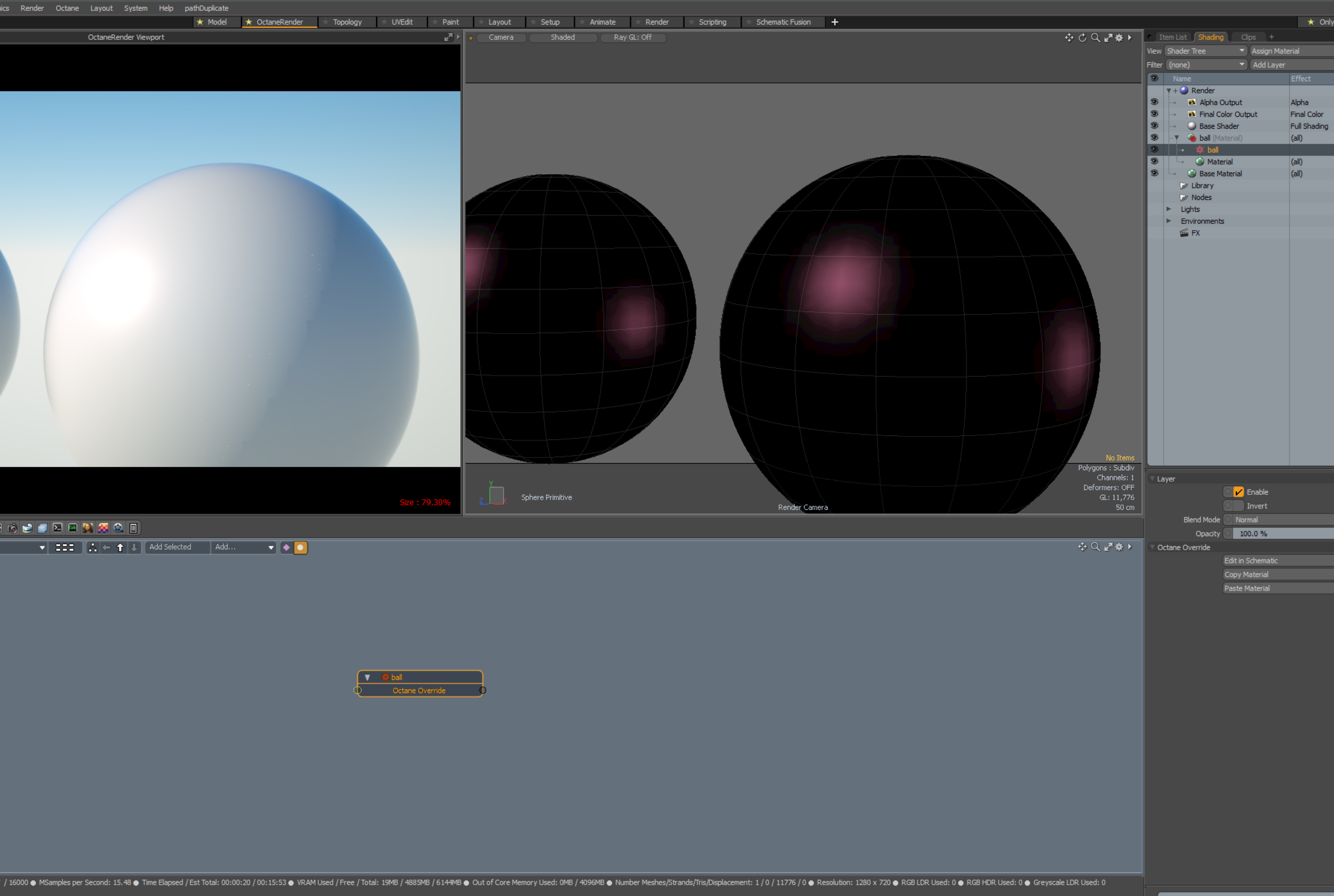

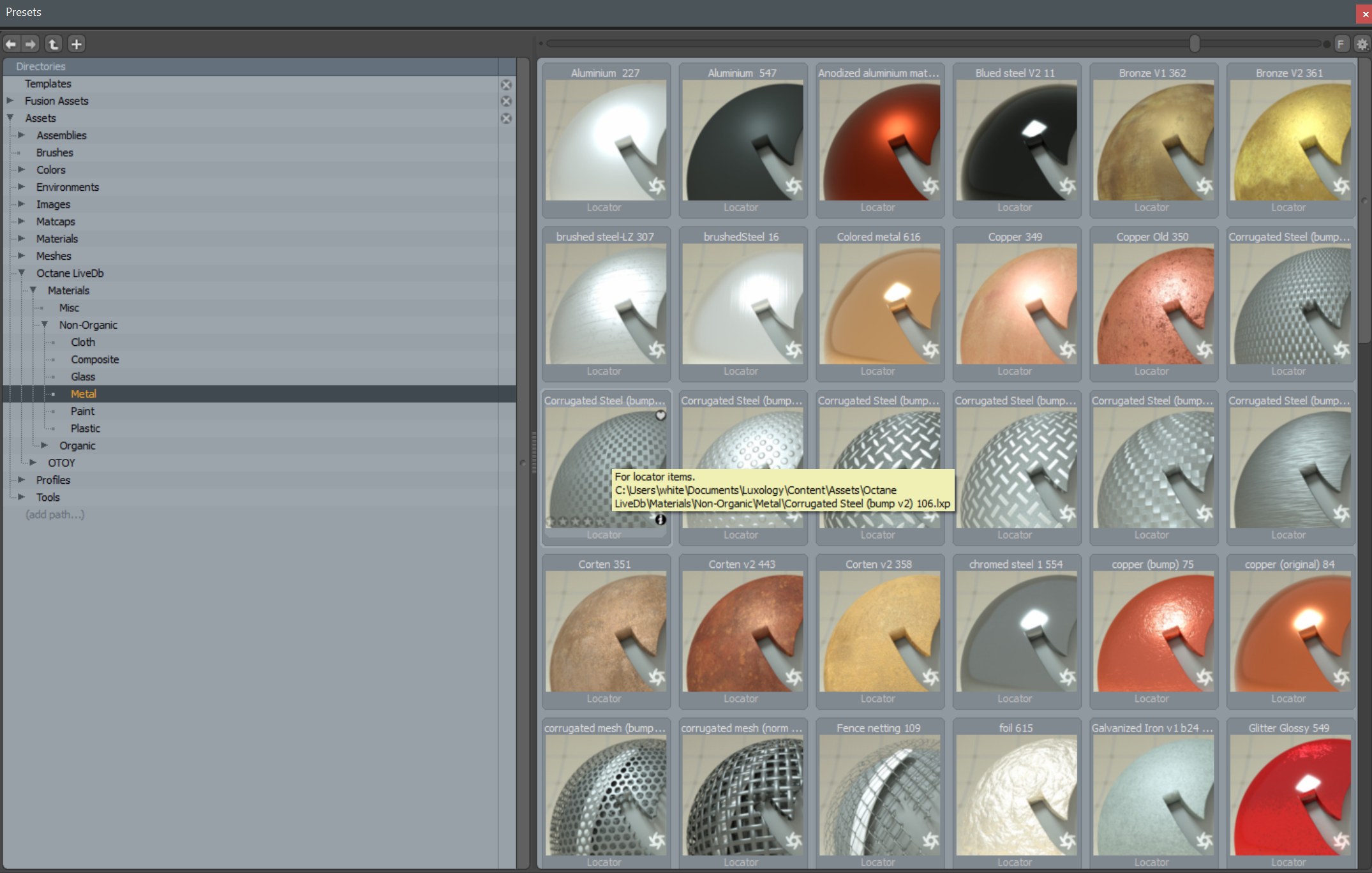

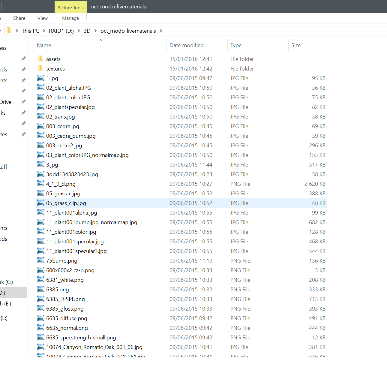

Hi - can you post a screenshot of the Modo->Preferences->Octane screen, the Windows Explorer folder where you put the LiveDb texturemaps, the Modo Preset window (F6) showing the LiveDb materials, and your Shader Tree and Schematic after loading and selecting a LiveDb material.
Paul
cristiangiro
Posts: 28
Joined: Sat Nov 28, 2015 9:29 am
Hi Paul,
here are the files
in the schematic window the material i applied is the anodized aluminuim from the live Db
hope this will help
thank you in advance
face_off
Posts: 15714
Location: Adelaide, Australia
I cannot see the LiveDb material in the Shader Tree. Are you rightclicking the Presets windows and selecting Load to load the LiveDb material into the Shader Tree? Dragging from the Presets window won't work (appears to be an odd Modo bug). This is covered in the manual at https://docs.otoy.com/Modo/?page_id=909.
