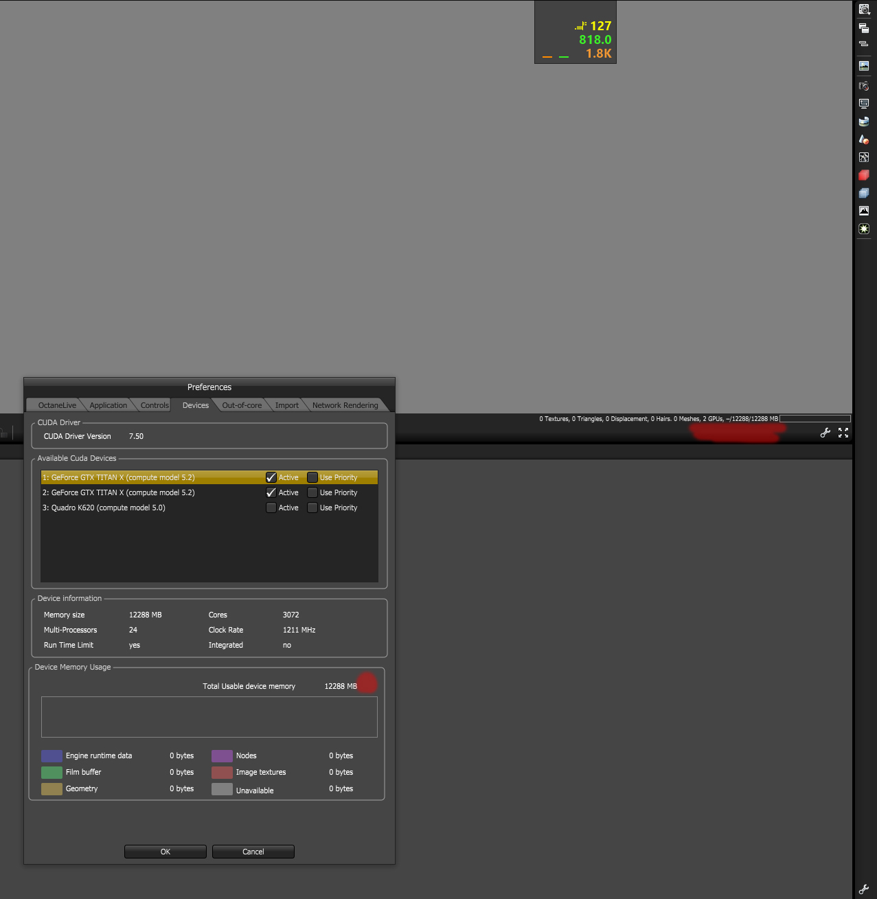

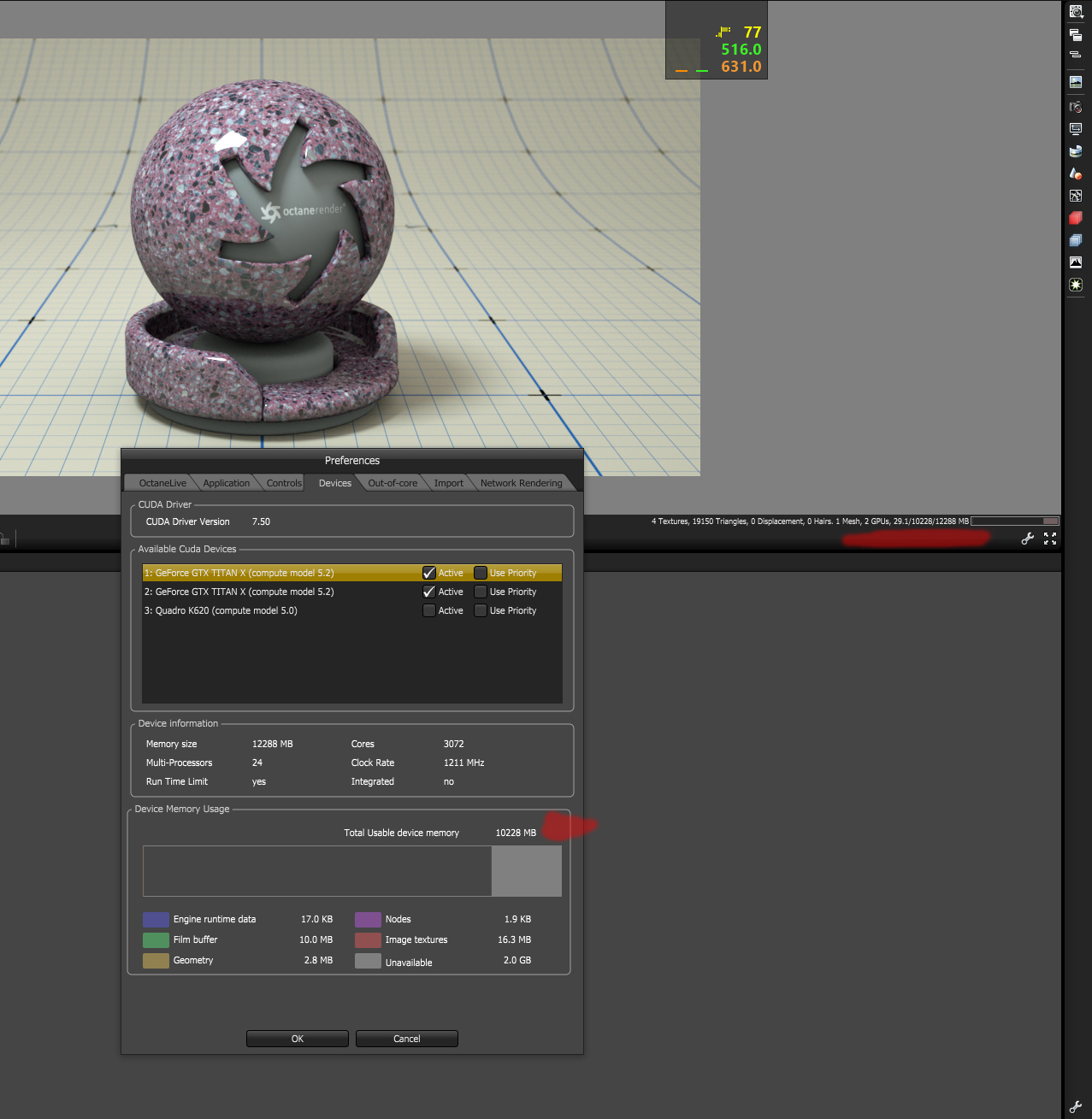

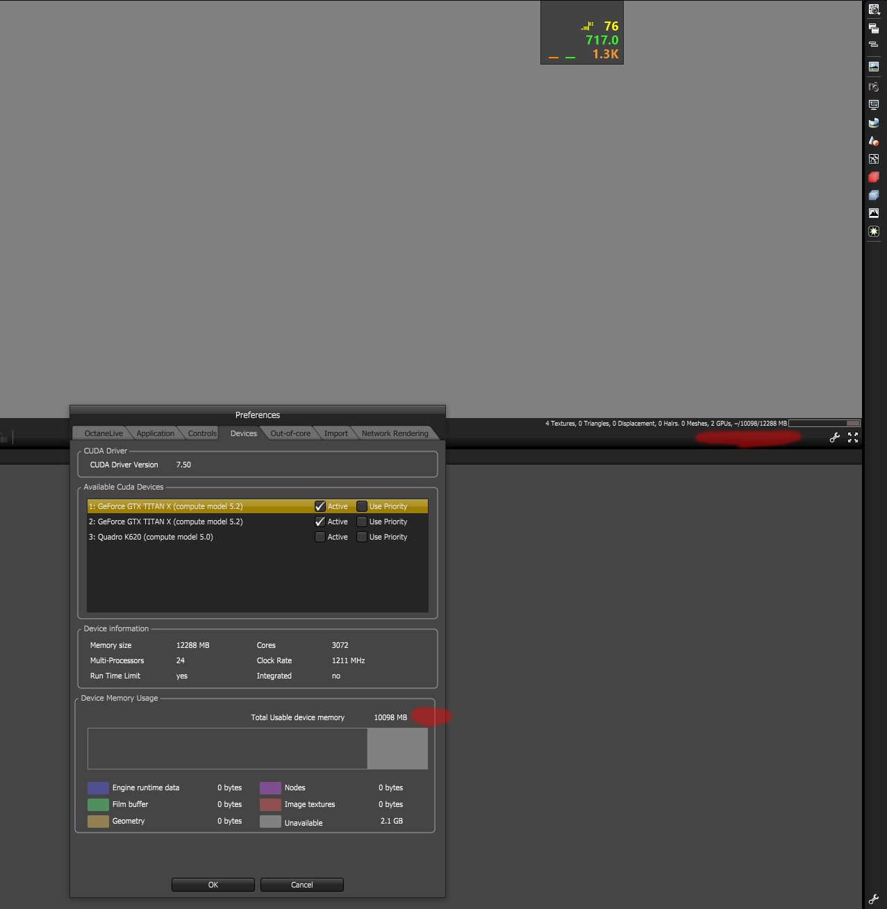

Hi guys , can anyone tell me what is the problem? Someone has the same problem?
1 OPEN OCTANE RENDER: MEMORY OK
2 SELECT A MATERIAL IN LIVEDB: MEMORY -2GB!
3 NEW FILE: MEMORY -2GB!
Regards!
problem GPU RAM evga titan x

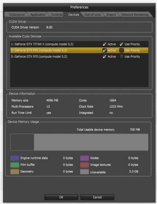

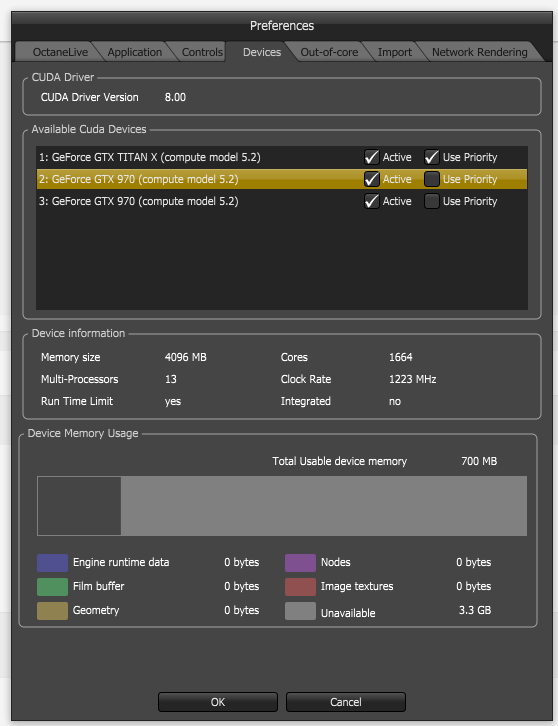

Hi paride,
unfortunately, as reported in the link suggested by rappet, the issue with win 10 affect also the cards not connected to the monitor and it seems constant, since a 6GB card loose 1GB of VRAM
ciao beppe
ciao beppe
