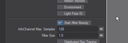

What version of the plugin are you using? If you are working with the 2.2 plugin, you can try to enable the "Start After Beauty" available in the Info passes tab.

Thanks Juanjo,
it works fine when starting the beauty first,
and it solved another issue i had :
Arbitrary, let's say i asked the render to reach 1000 samples,
it would stop at 450 samples and move on to the next frame.
The thing is that there was actually 1000 samples computed
but the Ms/s was adapted in the info view to match the render times...
Anyway thanks again for the quick response and solved problem as usual :)
