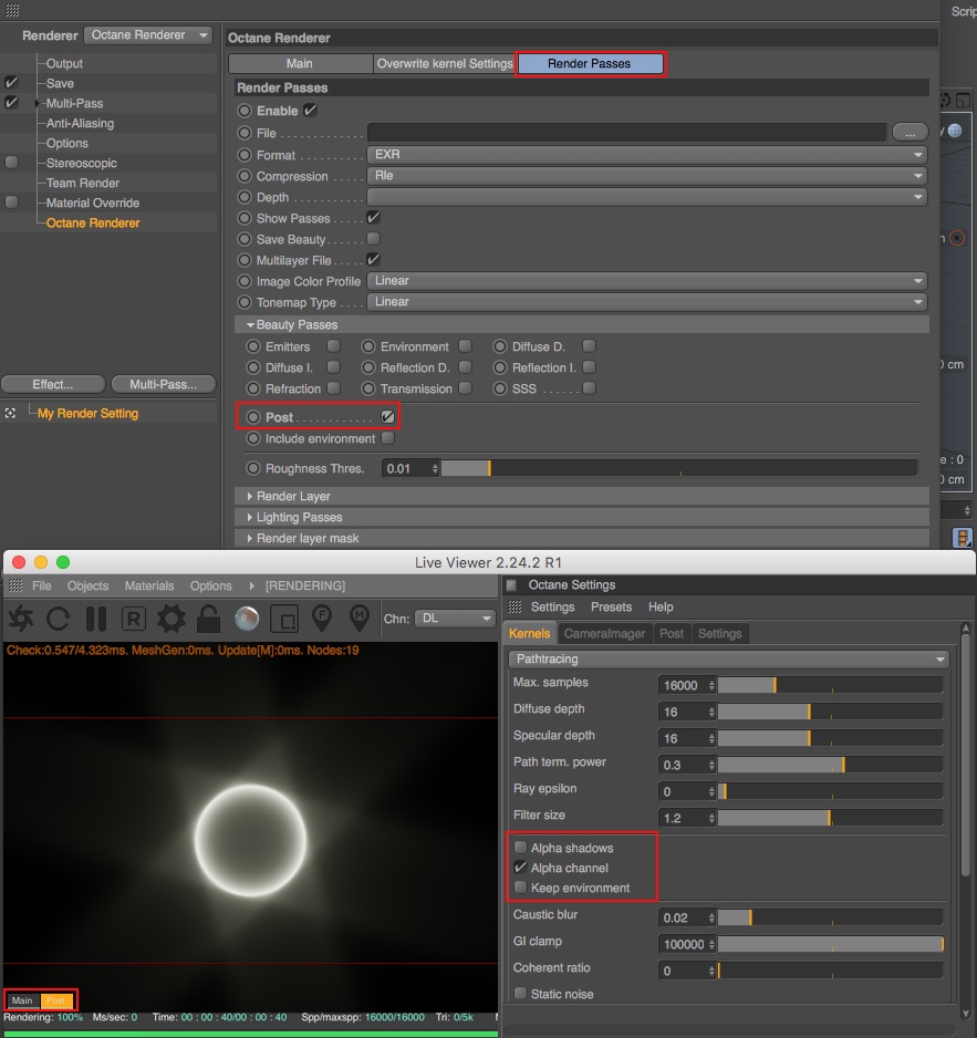

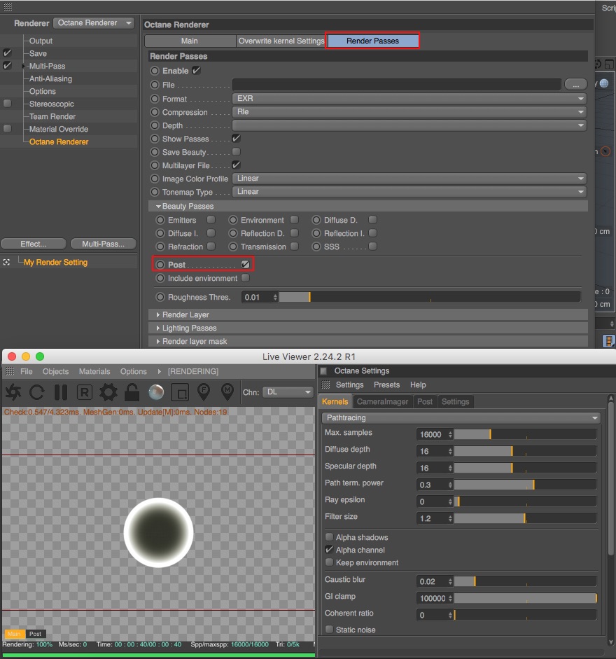

you have to active the Render Passes option and enable the Post processing pass, in this way you are able to compose the Post effect later on, even if the Alpha channel is active. See the example images, sorry they are from C4D, but you should be able to reproduce it in yours plugin, I hope:

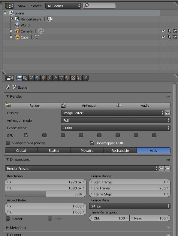

First off lets start with blender plugin doesnt look like there is the same options as c4d: (see image below)
https://www.dropbox.com/s/gtej6xq25uj28 ... u.png?dl=0
Ive played around with it a bit and I never see an option for post processing or multi layer exr.

see in the pic above is blenders node editor, in which i activated render passes and checkmarked all the passes which then activate on the compositor node render layer. If you can see there is no option for post, and there is no where where iet says multi layer exr. Ive been able to do a strict preview of the post process pass, but not been able to render it all at once into an exr or something..
