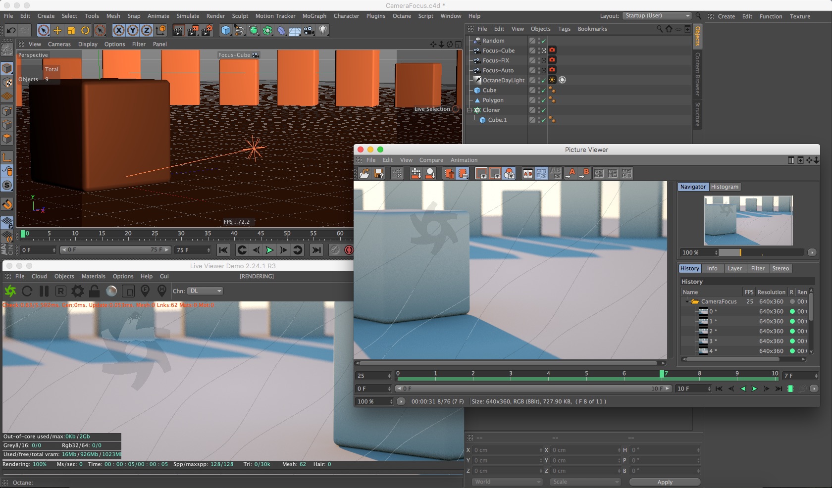

hi,
Octane for C4D always render the active camera, there is no differences between static or animated cameras. Just animate your active camera as always and add an Octane Camera Tag to expose all the properties for fine tuning.
Try with this simple example scene, load the scene in GPU and then, click play in the time-bar to preview the animation in Live View or render to Picture viewer ;)
CameraFocus.c4d.zip
(91.62 KiB) Downloaded 203 times
ciao beppe
