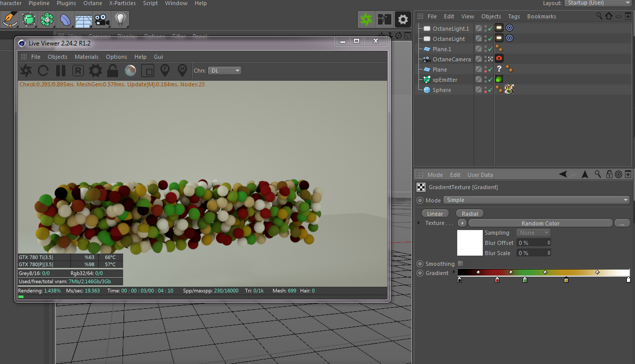

I upgraded both versions of C4d and octane, now i see particles, but i don't see colors. I,m using for example a mix material with two rgbspectrum applied to the emitter but nothing changes in my octane viewer.
I'm still using as reference the tutorial https://vimeo.com/124982906, at 17:01 colors changes, in my scene not. I post here a picture:

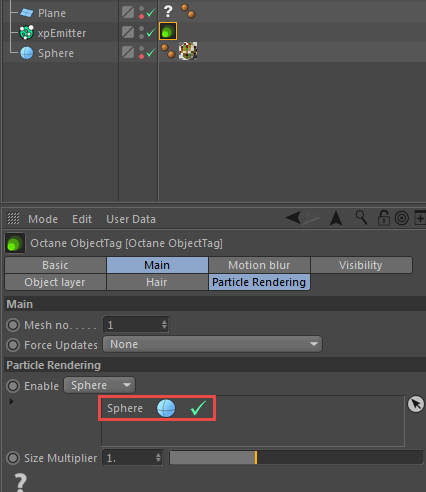

[/attachment]
I have been messed also confused since v2->v3 period. But i remember that's loaded to Object tag's object slot as in image anymore. I may bring old behaviour again but don't know yet. I suppose this way is better and allows more flexibility. I'm planning to work on XP for better integration if we can get extra features in SDK soon.

yes, applying a sphere on the particle rendering object tag, it works. Tnx

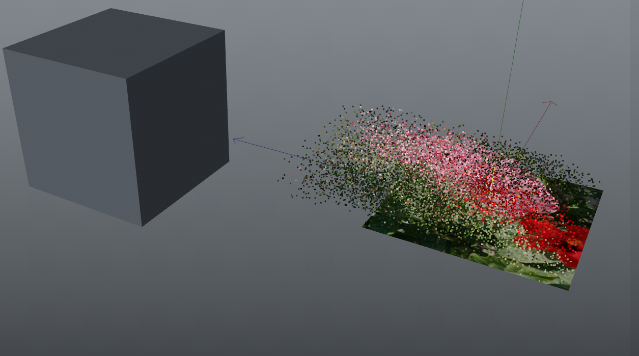

will there ever be a way for Octane to receive the emit per texture channel function ? I have attached a scene for you. Thanks

Studiolocal wrote:will there ever be a way for Octane to receive the emit per texture channel function ? I have attached a scene for you. Thanks
Problem is about lack of assignment of custom colors on render instances. Because particle engine use that(render instances) and currently no way. That's the reason why i couldn't improved the engine more. I'm waiting for new possibilities, perhaps with OSL implementation on V3.
