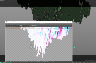

I'm having a weird issue with the latest update of Octane. Version 2.24.2 R1
I've updated the Octane stand alone too and I've also got my Nvidia driver updated to the most current driver. Also my C4D is r16.051.
When I render a scene, the lighting seems to be suddenly really extreme... the whole scene looks white. What's wrong here please? ... it was perfectly fine before the update.... I've checked multiple scenes and its the same in every one.
In the image you can see the render viewer is showing all white objects when they should be dark green...

I'm getting the same issue, when I first Send a scene it's lighting is extreme, I have to turn lights on and off again to get it to light properly.
First "Send your scene":
After toggling the lights off and on (this is correct):
This happens in 2.24.2 R1 and also in the 3.0 Alpha build.
@Aoktar: I've sent you the scene via PM so you can see what's happening.

brasco wrote:Hi,
cheers
brasc
It's a issue which because of layer texture in lighttag. I'm not sure that's supported well or not with layer+render2shader. Rendering of C4D layer shader that's always a bit buggy. I couldn't made it better. Best to wait OSL and implement it with native ways.
Anyway I'm going to take look for layers again.
