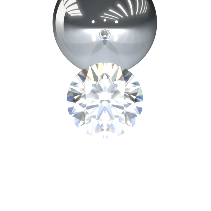

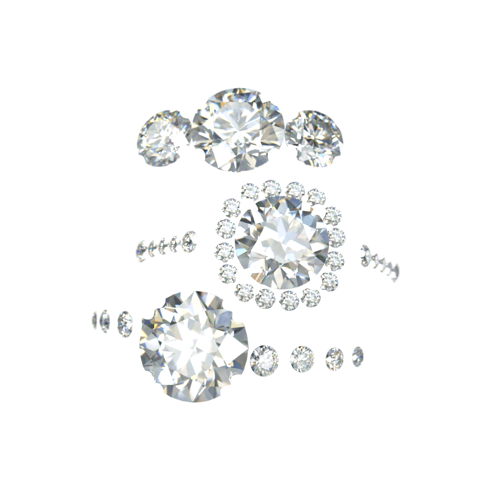

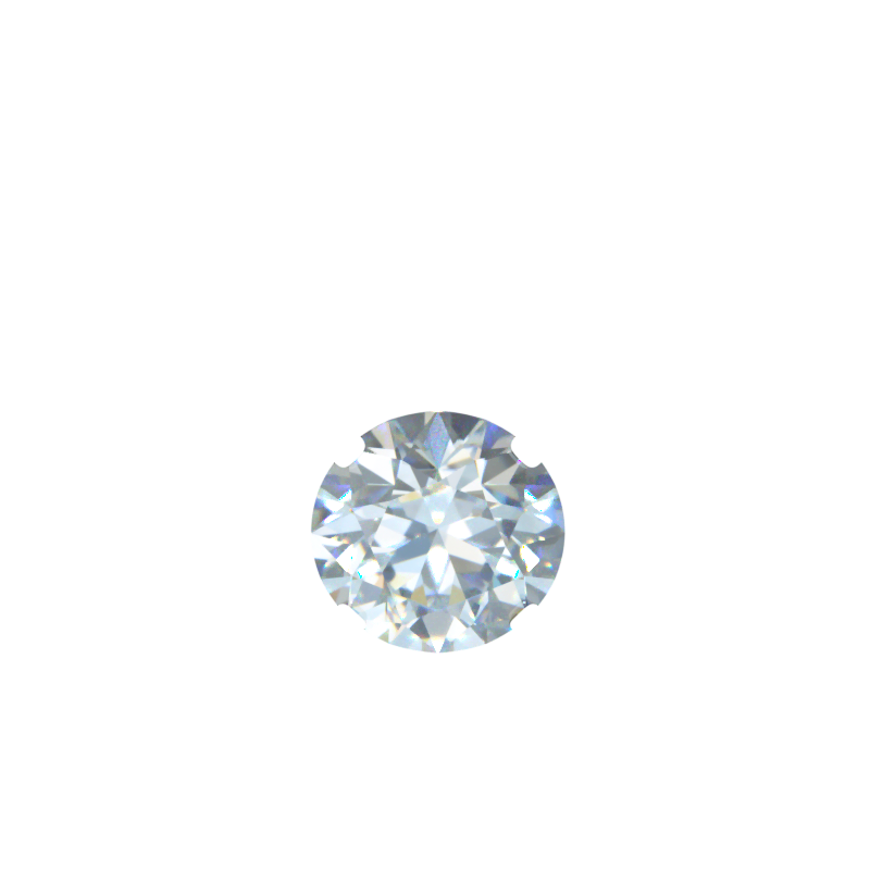

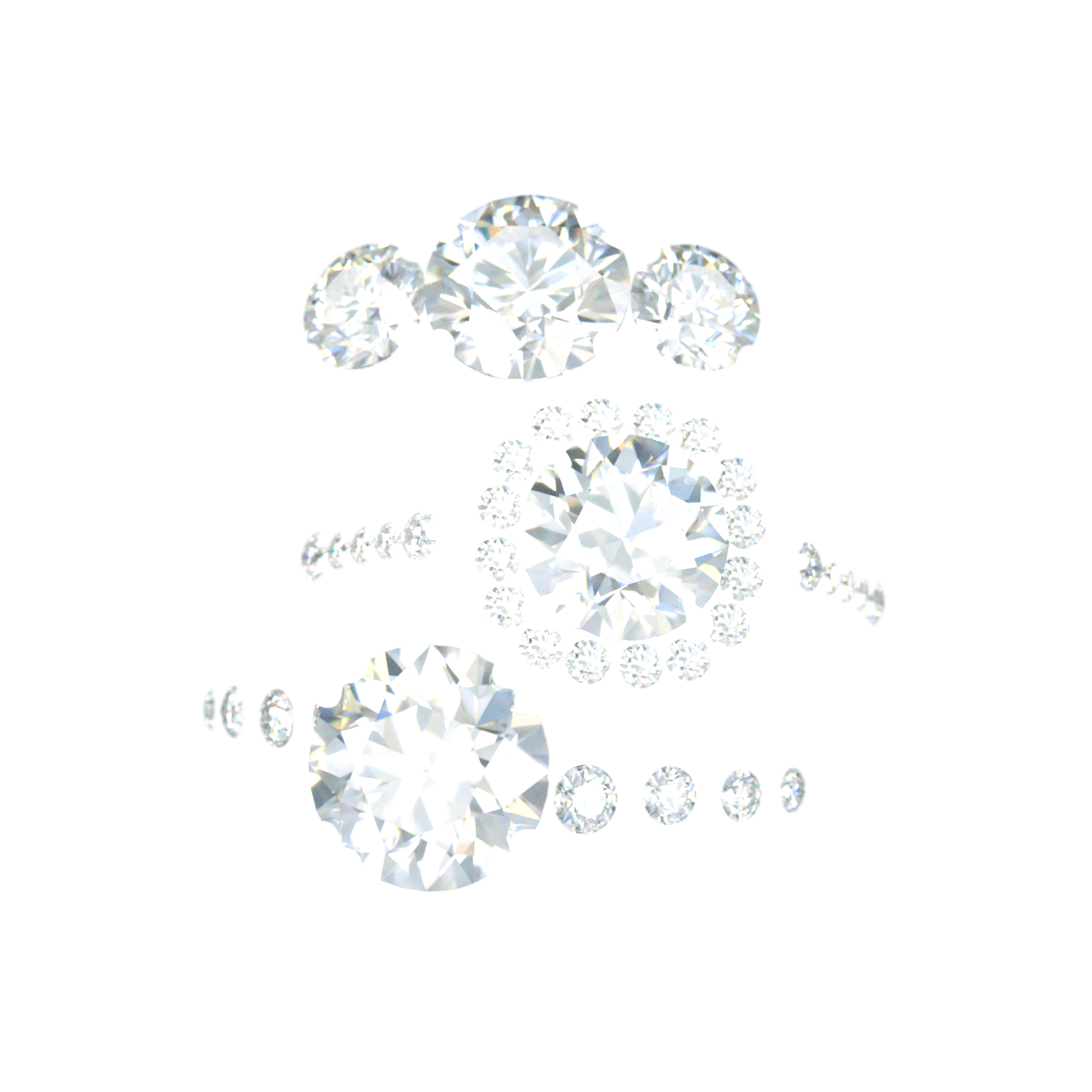

Hey guys I've got a some questions regarding the diamond material. I'm rendering using the Rhino plugin but I wanted to post this here to get some more eyes on it. I've been running tests using a range of HDRI from the Lightmap plugin and I'm using a few IES lights in the scene as well. The problem is it seems like I can't really control the colors being refracted inside the diamond or the color of the diamond in general. Mostly I'm just getting these yellowish washed out diamonds that aren't really giving me what I need.

Hey guys thanks for the input. I'm running my HDRI lightmaps at a gamma of 1 because this is the recommended setting from light map, http://help.lightmap.co.uk/hdrlightstud ... octane.htm I also got a email breakdown from them if anyone wants to read it. The forum is not letting me upload my hdri maps but they are mostly dark backgrounds with various lights. Adding IES lighting does improve the diamond reflection but really doesn't let me control the color of the diamond which is what I'm really after. I've been working in live mode a lot to test different light sources. The diamond material itself has a Dispersion coefficient of 0.044, and an index of refraction of 2.419.
I've been rendering using PMC Kernel
Ray Epsilon at 0.0001
Haven't messed with too much else in the Kernel settings because I'm still learning my way around things and haven't been able to dig up any optimised settings for this, same with the camera imager. Definitely open to suggestions. Thanks!
