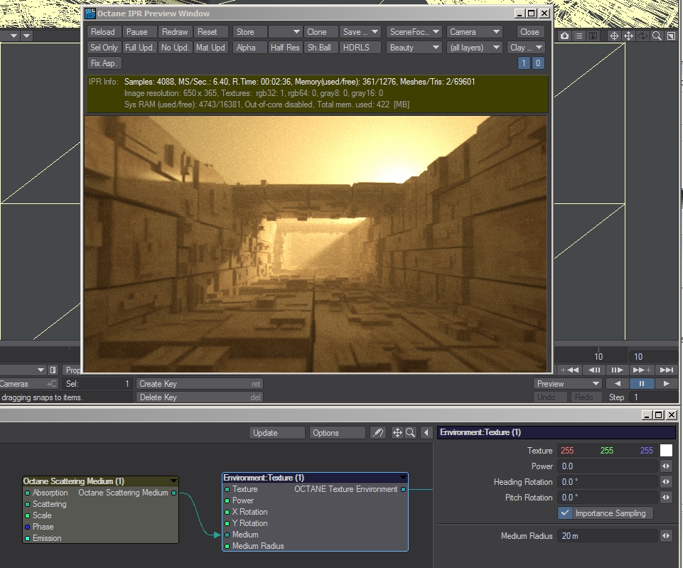

Hey,
I've seen a lot of posts showing off Octane 3 and the new fog feature.
Is fog available in Octane for lightwave and if so where might I find it?
Cheers.
Intel i7 6700k - 64gb Ram - 6 x 980ti
juanjgon
Posts: 8867
Location: Spain
You must use the new "medium" inputs in the environment nodes.
From the releases notes:
- New inputs in the environment nodes to link a global scene medium node. This means that users don't have to model a sphere around the camera anymore if they like to have camera fog or mist.
- New parameter in the environment nodes to control the environment virtual sphere radius.
-Juanjo
