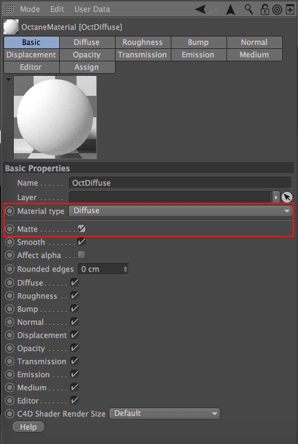

Perfect, then you need only to activate the matte option of a specular material assigned to the floor for the first technique:

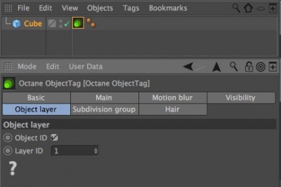

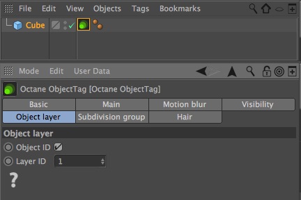

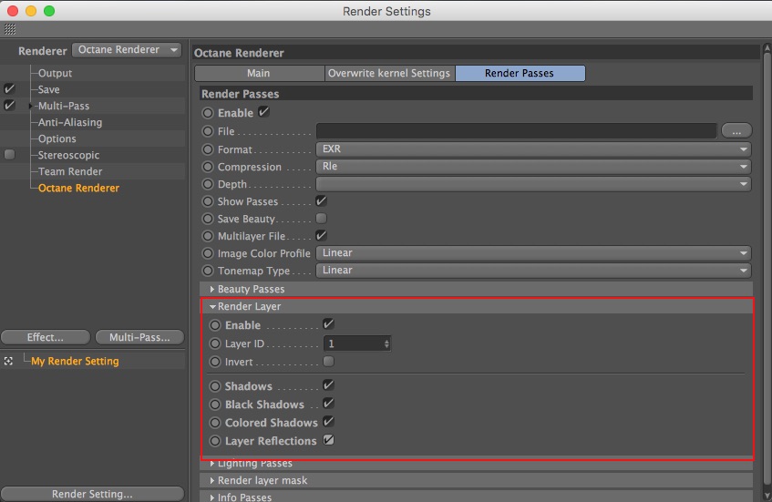

or use the object tag to define different render layers and activate the proper option in the render settings:
ciao beppe
