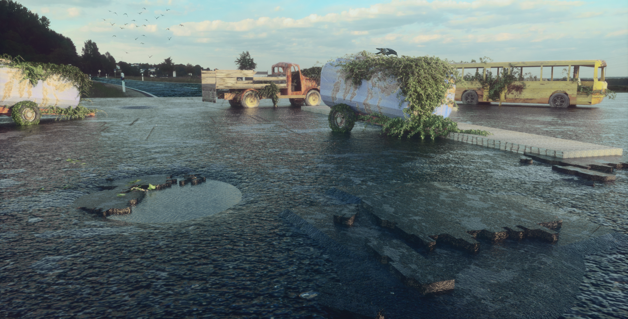

What is the best way matching background animation with hdri environment. I mean if you watch my short clip u can see background is not moving. When I crate a sphere and reverse normal still it casting shadow. How can I animate my camera with background hdri

It's same for any render engine. Environment textures will not mapped spheres as small sized. It's a spherical environment with infinite radius. So just will answer to camera rotation not position. You can try a back plate with texture.
