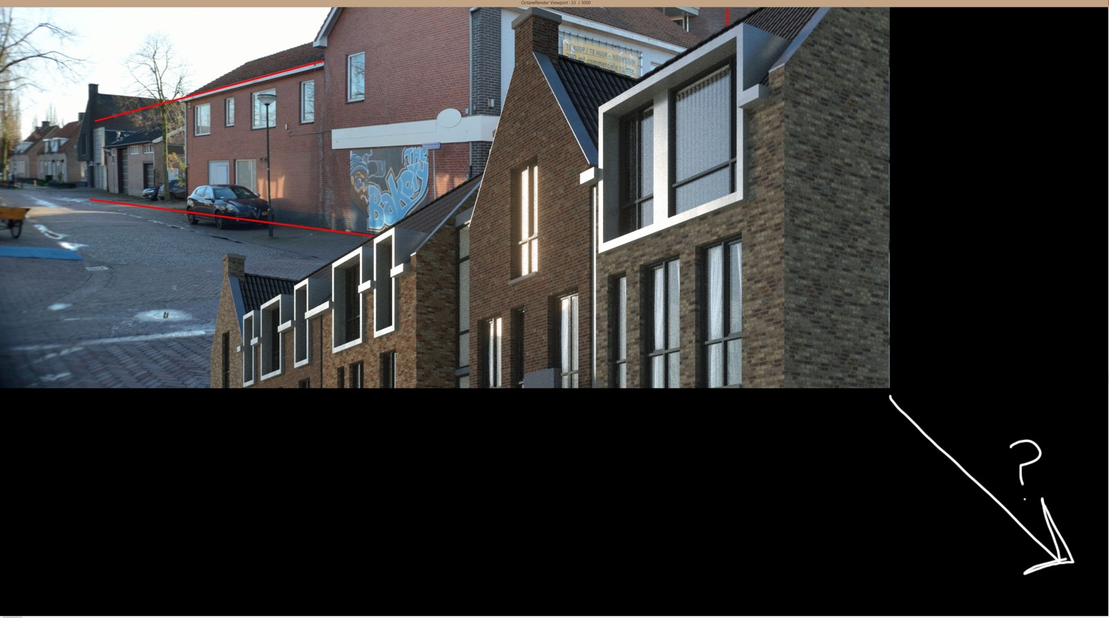

The render viewport is not resizing when enlarging the resolution when a smaller background is loaded.
(it shows it bigger, so the scene is enlarged and can be saved good)
I guess this is normal? ( I would prefer showing the complete resolution and then loade background (too) small from upper left corner)

Hi Jeroen - yes, I believe this is the case when you have background image - the render displayed gets resized to the background image size. If you save the image to disk, it should be saved as the correct resolution.
Paul
