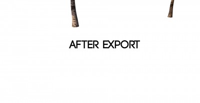

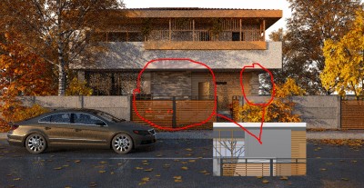

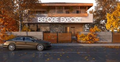

Hello Captain su plugin it's still that weird thing after exporting to OCS
see attached images.
weird export issue

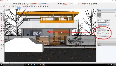

Also, i have a worse problem with material scaling , and i do not know how to fix it , maybe you could help me with this , after some work on the material the textures are loosing scale( see the images ) and i have to greatly increase the scale of the texture in sketchup in order to get a good result in octane , by doing this i can't see the texure in sketchup no longer,i just see a color
and so far the only solution that i have found is to simply delete and remake the material .
If you UV your geometry you must pay attention to UV space and scaling, do you? If not use box mapping built in Octane with scale 1.

The texture scale bug has been there since the start. Besides random crashes on larger scenes this is the biggest issue I have with the plugin. It makes it effectively unusable. Deveopment of the pluging still seems to be tentative unfortunately.
