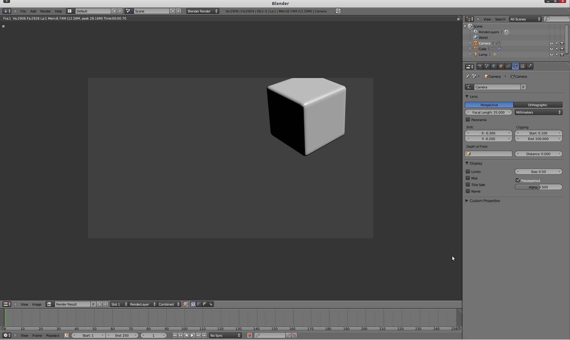

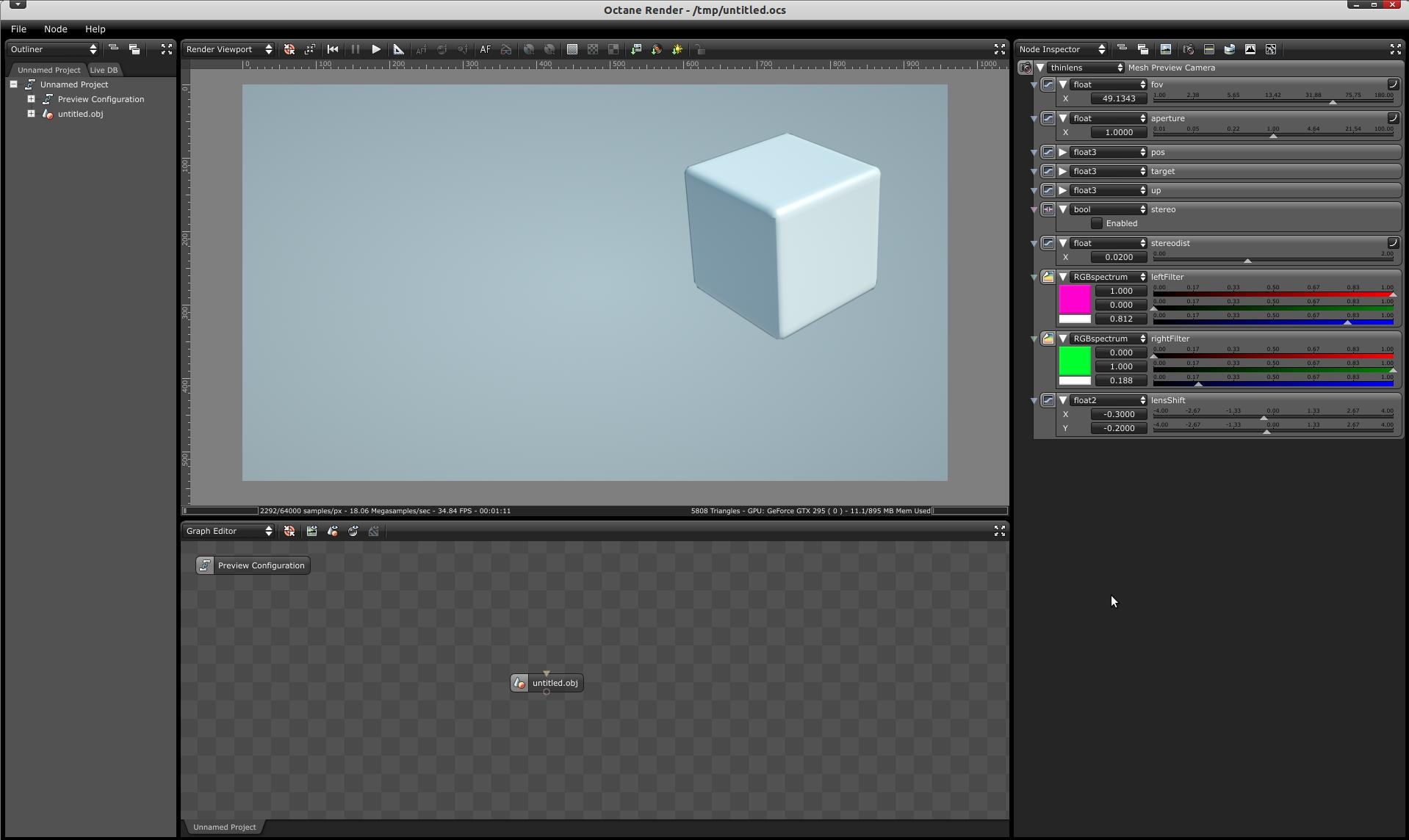

while I was adding the export of lens shift from Blender to Octane in the plugin, I noticed that same values don't shift the scene the same way in the 2 products... The 'right/X' value seems almost OK, but the 'up/Y' one doesn't match.
Here're a couple of screenshots so you see what I mean. Am I doing something wrong?
Thanks,
Lionel

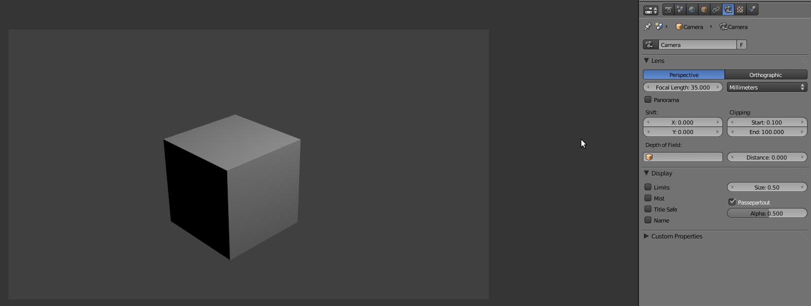

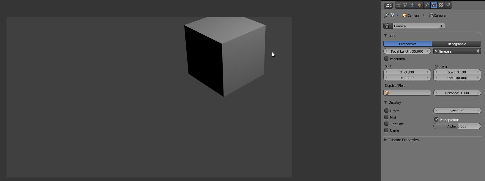

Obviously Blender is doing something different here. Can you show us the shifted and the non-shifted Blender renders?

Yep, here are two screeshots taken in a row.

Ok, it looks as if in Blender the shift is always relative to the width, while in Octane the shift is relative to corresponding axis. I'm not sure, if the behaviour in Blender stays the same in portrait mode.
If my assumption is correct, the shifts to export are:
Code: Select all
OctaneLensShiftX = BlenderLensShiftX;
OctaneLensShiftY = BlenderLensShiftY * ImageSizeX / ImageSize Y;
Cheers,
Marcus
