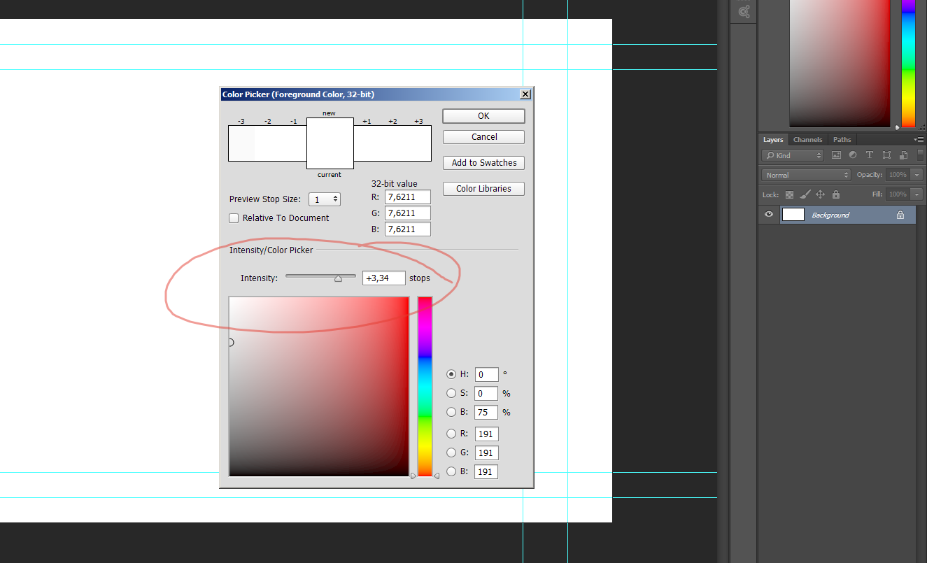

Hi here is good tutorial about setting up HDRI in octane render http://www.vizpark.com/hdri-lighting-wi ... ne-render/ ;)
and here is workaround in photoshop for sharper shadows in HDRI

Goldisart
Posts: 780
Joined: Sat Oct 26, 2013 8:47 am
in photoshop you can use the intensity
