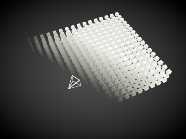

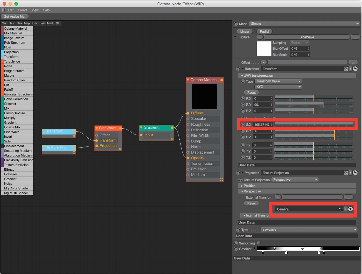

I got this working with render instances using Octane gradient with Perspective projection linked to camera.
Theoretically it should work with scatter, xp or any other Octane instances regardless of mograph.
BUT.. I couldn't figure out how to stop gradient from repeating. Still, with careful adjustments it could be useful.
You can control the falloff with S.X value. Also, I'm not sure but it could probably be linked to anything, not just a camera.
Node setup:

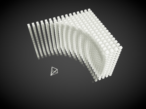

And if we change projection to 'Spherical' after that we get an interesting effect and it's still linked to Camera!
