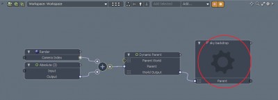

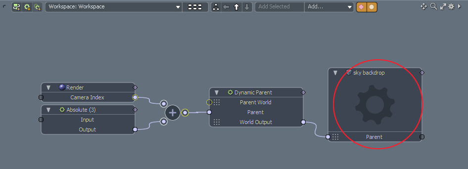

EDIT: I've been playing around with this a bit more and I think I've narrowed it down to the Nodal Workspace window when 'Display Mesh/Material Previews' is checked. In my attached screenshot, If I move the Sky Backdrop 2 locator when this screen is open, the cog (circled in red) briefly updates with a thumbnail preview then followed by a crash. You can work around this by disabling 'Display Mesh/Material Previews' then moving the locator then enabling 'Display Mesh/Material Previews'. Seems to be finicky in what order things are done.

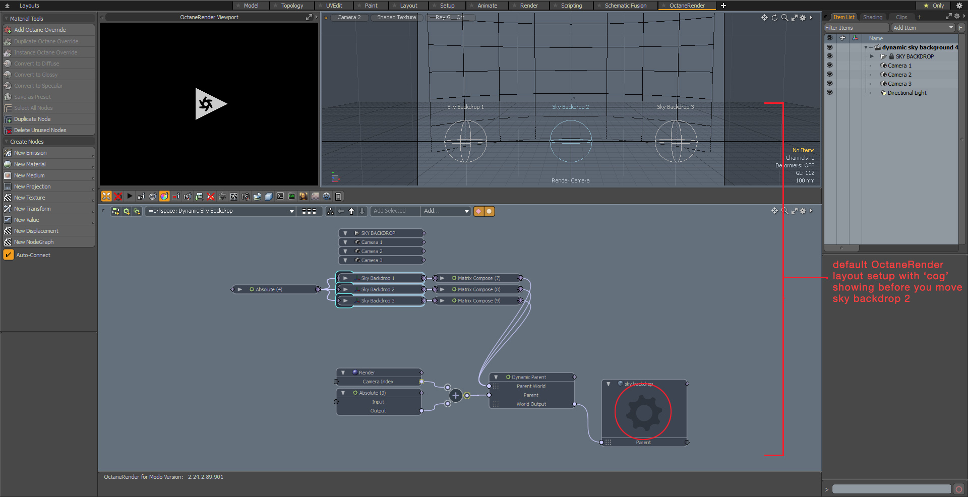

Is the OctaneRender setup window open when you launch modo, or did you open it after the scene loaded. I can reproduce this crash every time but...only if the OctaneRender setup window is open upon launch, and the sky backdrop node is a 'cog' and not yet refreshed to a thumbnail. Would you be able to check this again with Modo901 sp3 and with the default Octane Layout open on launch (as per my screenshot)
My exact procedure:
- Open sample scene
- Use default OctaneRender layout (with the node workflow window open by default)
- Check the sky backdrop node is a cog image
- In the 3d viewport select the sky backdrop 2 locator and move it.
- Notice the cog image refreshes and is replaced with a thumbnail
- Modo crashes on mouse release
If you open the node workspace window after the scene is open and the thumbnail is there already, it will not crash. It seems to crash when this window is open while the thumbnail is being generated.
