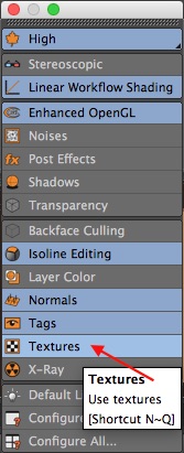

So, I have a c4D scene, objects with textures, and so on. But, is taking quite a while to load the scenes cause of the view-port preview. Any way to avoid this loading time or minimize it ? I don't really need it, I mean the view-port texturing preview. Maybe is related to the Octane/Settings/C4D shaders ? :?:

if you mean in the C4D viewport, there is a proper option in any windows of the C4D viewport:
If you mean something else, please, could you be more specific?

That is perfect. I just need it a way to deactivate the texture view-port option so the Octane textures don't show up on the view-port, takes time for loading. I'm using many mix shaders.
