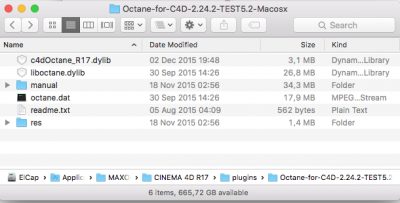

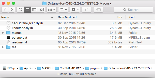

no problem here with R17 on 10.11.2 with both stable v2.24.1-R3 and test 2.24.2-5.2.
The test version has a proper R17.bylib file, do you have the same files as in picture in your plugin folder?
