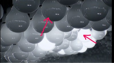

Hello all,
I am trying to recreate the lighting effect that is in the image below with a light bulb model in Cinema 4D and Octane. I am a fairly new user and I am not sure how to achieve the glow that the light bulb emits while also having the dark white texture with specularity when the light turns off. I have tried using mix textures, one with a black body emission and another using a white glossy material with some falloff, but with no luck. Does anyone one having any tips or ideas that could lead me in the right direction, because right now I am just spinning my wheels on this.

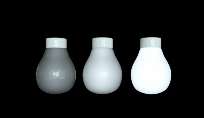

Here is a quick approach. HDR is missing.
bulbs.rar
(103.83 KiB) Downloaded 145 times

Thanks very much Unsergio. I will test it out and let you know what results I get.
Thanks again. :D
