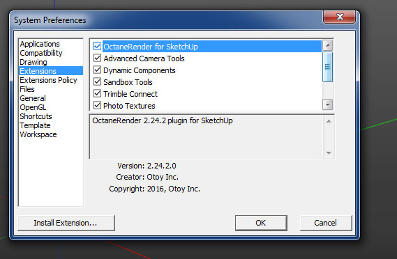

3. Open 2016 and go to windows->preferences->extensions and mark Octane plugin (click just once and wait for network settings approval) and restart Octane.

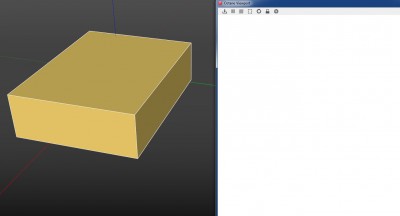

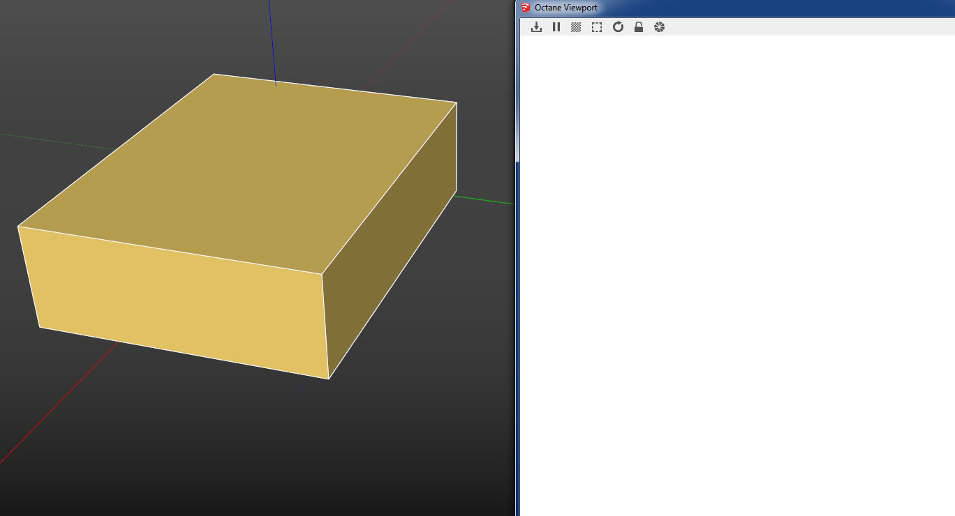

A bug: when I open the plugin the viewport is white. I must orbit a scene to get proper viewport activity.
