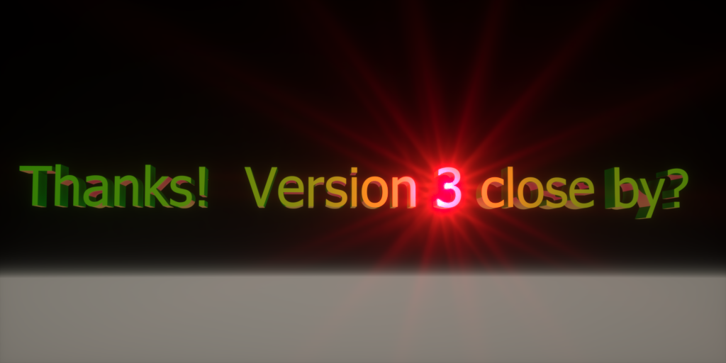

I had this exact thing happen to me. Here is my example. I posted this in the main OcDS forum a couple days back (not to show Paul an example of a bug, but as a gesture towards being excited about Version 3...)
Check the 3, that is reflection of sunlight causing the pixelation. It would not unpixelate no matter how long I rendered for (24K samples...thats 24 Kazillion). It was a shame, because I could not land the effect I wanted. I used post processing to sort of cover up, but you could still see pixelation.
It wasn't a mood shot or anything, just glitz and glare. Outside of Photoshopping it I don't think there really was a way to mod it via dimming and achieve the same effect.
