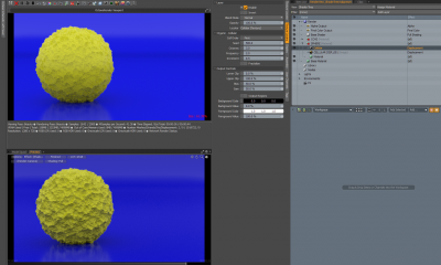

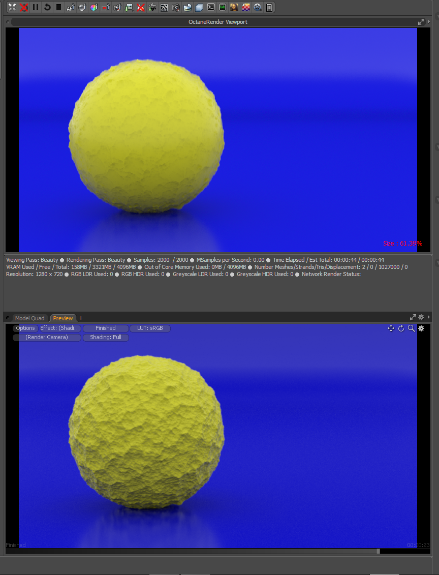

I'm not sure I know why I'm seeing odd displacement behavior in the Modo plugin. While the displacements I have in the Modo Shader tree are working in the Octane viewport, the displacement itself is not matching up with what I'm seeing in Modo's Preview. I'm wondering why Octane is behaving this way? How do I get Octane to match up exactly with what I'm seeing in Modo's preview?
I have included a screen capture of what I'm seeing.

Octane does not render Modo procedural displacement maps - so use an Image and set to Displacement. Also - the displacement amount may not exactly match - so convert the material to an Octane Override, and manually adjust the Displacement Amount and Offset to suit. Finally, you can turn ON Preferences->Octane->Use Modo Render Cache, and turn ON Kernel->Settings->Polygon Displacement, and the actual displaced polys will be loaded into Octane (but this will use many more polygons in Octane - so set your Modo Render->Displacement Rate cautiously.

Procedural displacement seems to 'almost' work when 'Use Modo Render Cache' is turned on. I've tried it using both the Modo procedural noise texture as well as a baked version of the same texture. The results are the same and are reflected in the original screen captured image in this thread. Basically what I'm experiencing is that the displacement I'm able to achieve in Modo is for the most part unobtainable in Octane. Very frustrating indeed.

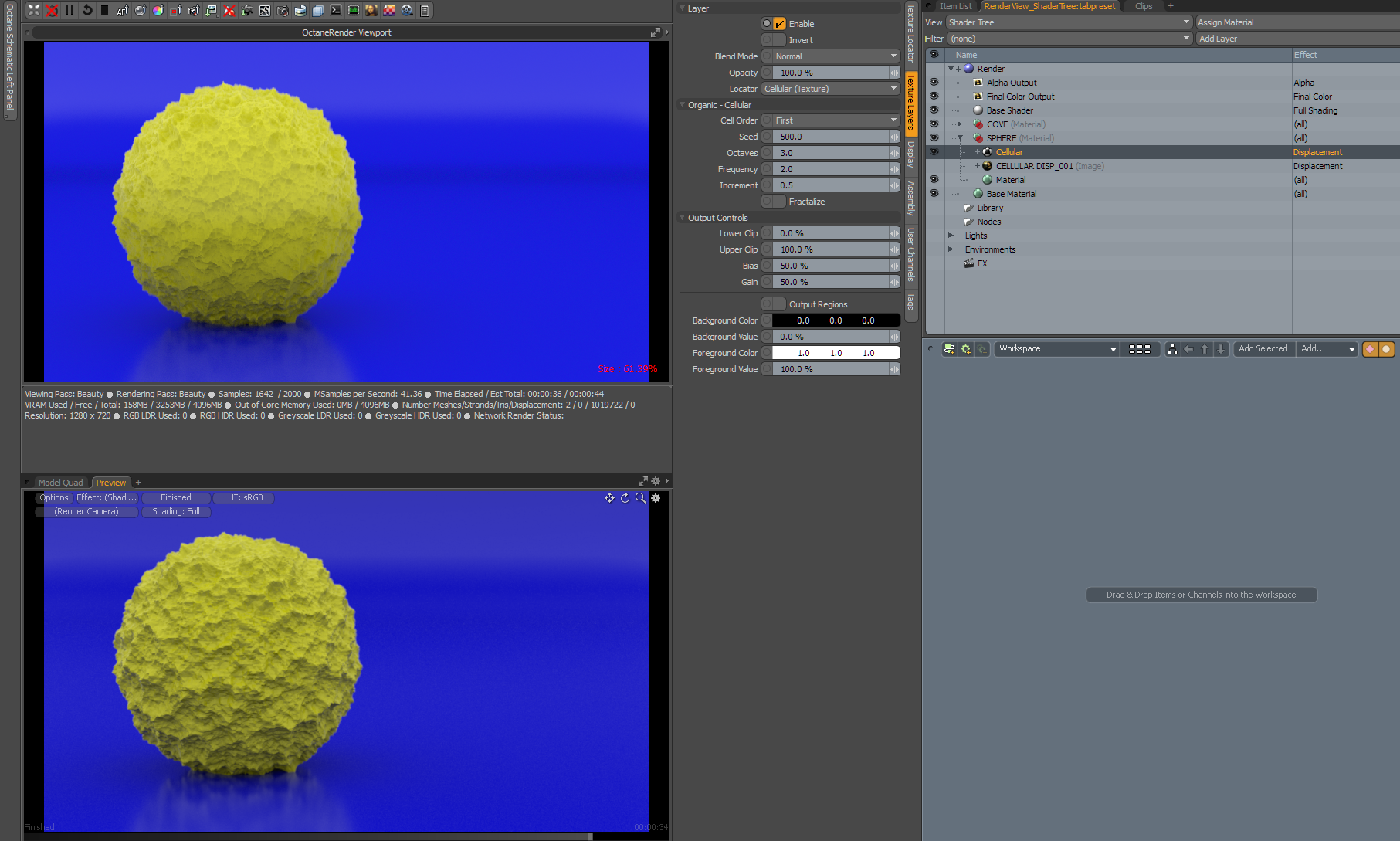

So... it seems 'use modo render cache' breaks displacement. Plain and simple. This is the cause for my frustration because it seems to partially displace and the results are reflected in my original screen capture posted in this thread.
The setup that seems to work is to have 'use modo render cache' deactivated / turned off. Then the only option is to use a baked image of the procedural noise texture and then set the effect mode in Modo's shader tree to displacement. Be sure to set the baked image's gamma to 1.8 instead of the Modo default of 1 (very important). Adding an Octane override is not necessary for the displacement to work however the results are not as good as what I'm seeing in Modo. A tear does seem to creep up at the bottom of the quad-sphere.
Basically I'm going to avoid 'use modo render cache' altogether as it seems to have cost me two days of testing. Because I was seeing partial displacement results when using this feature along with a procedural noise layer, I believed that it should be working but that I must have had an incorrect setting or that I was missing something. To be honest I'm not sure why the plugin would show partial displacement at all. If procedural noise doesn't work then, in my opinion, it should have no effect on the geometry at all. A partial reaction to procedural noise displacement only confuses the matter, as it did with me in this case.
In the end, I've concluded that the 'use modo render cache' is buggy and would recommend that fellow Modo users avoid using it for the time being.

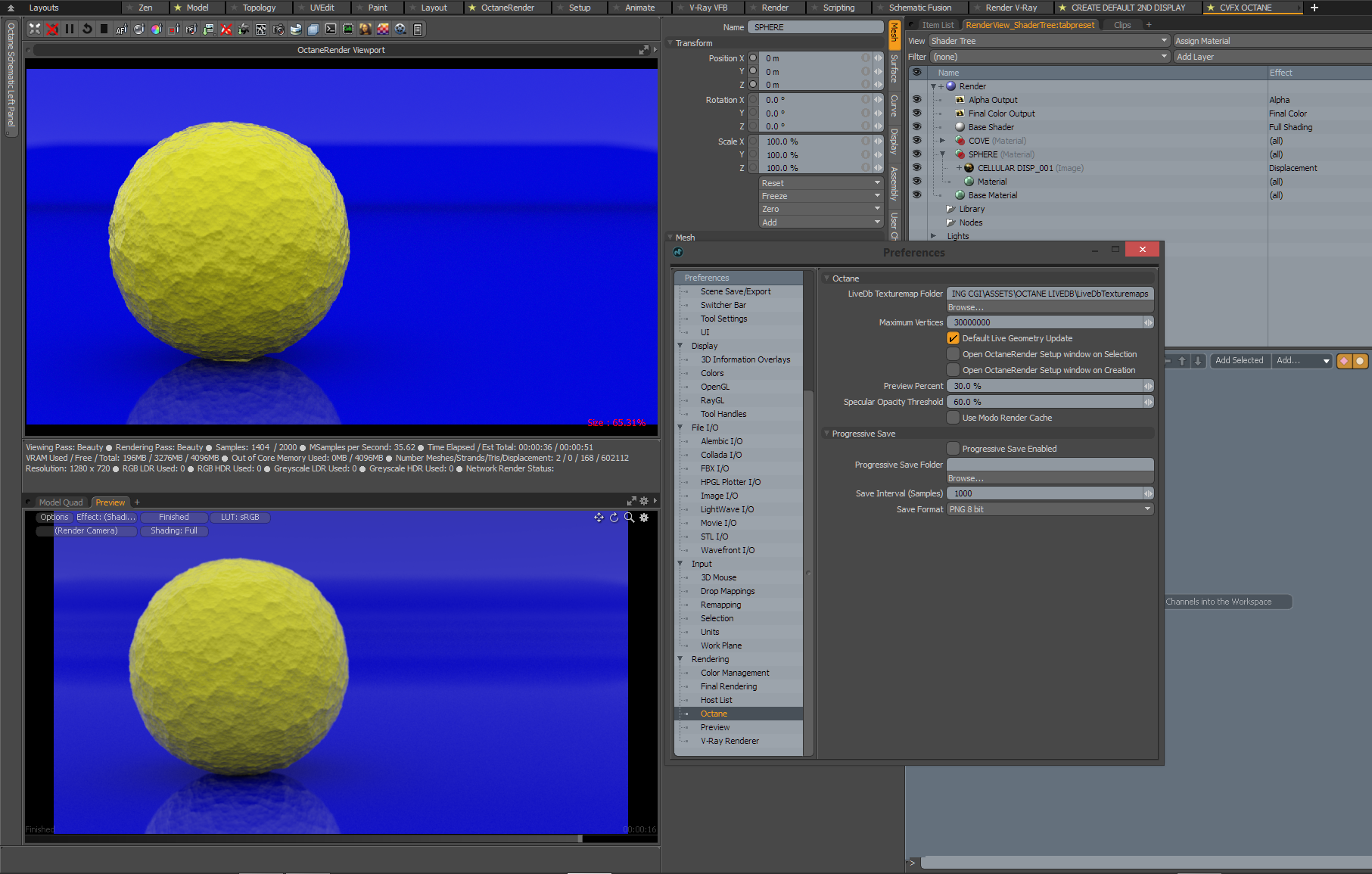

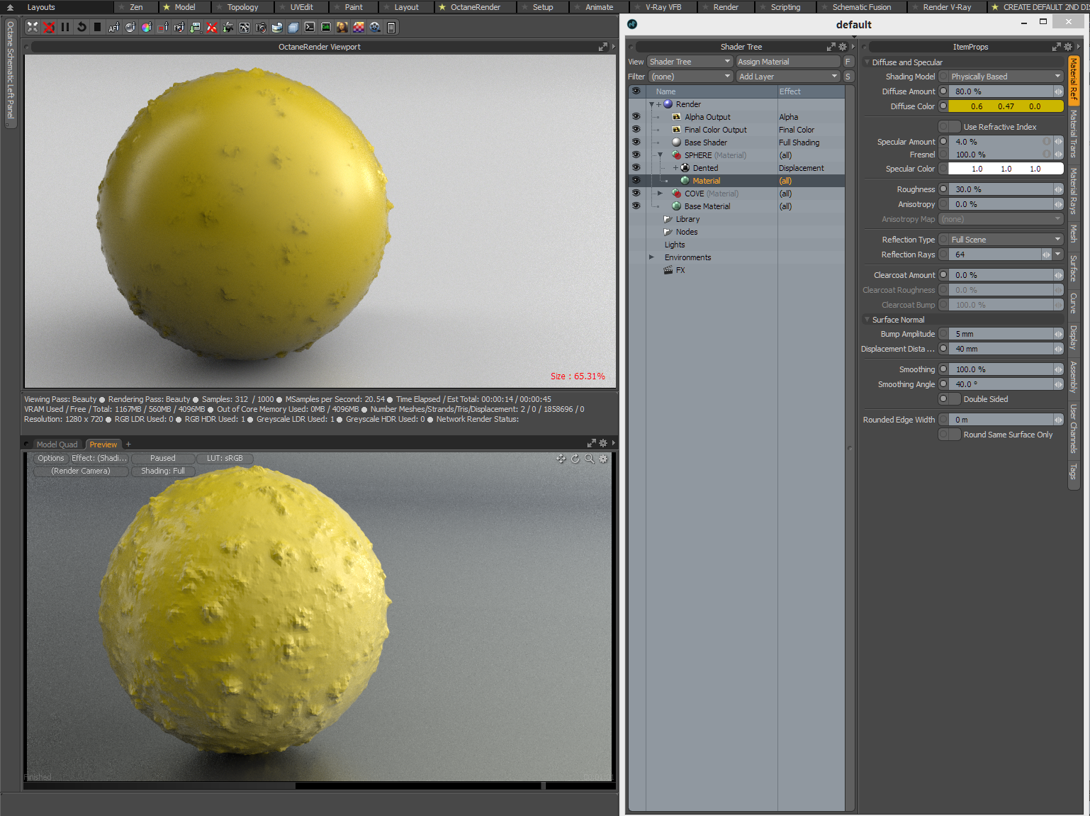

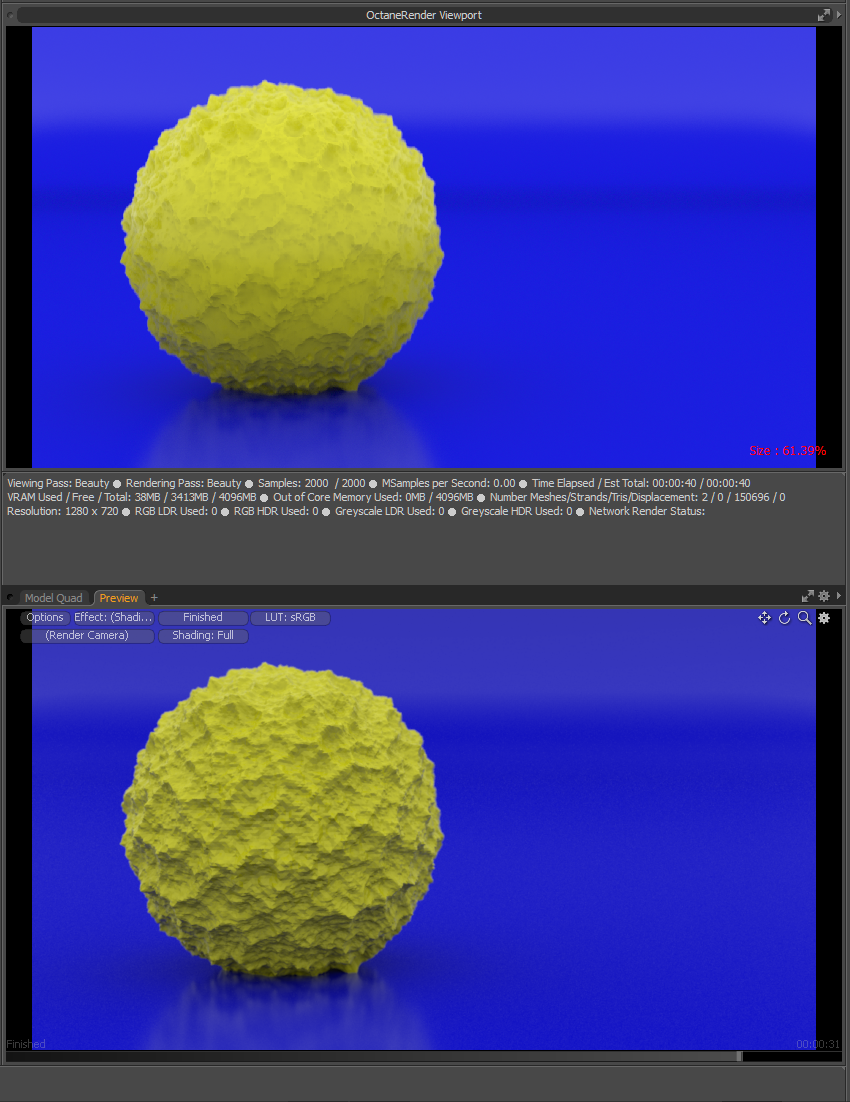

I have included three screen captures below. One shows the 'use modo render cache' feature turned off and using as baked version of the procedural noise layer set to displacement (gamma set to 1.8) (WORKING). The second shows 'use modo render cache' activated using a procedural noise texture set to displacement and we're seeing partial results (NOT WORKING). This was the root of my two day head scratching and problem solving. The third image also has 'use modo render cache' activated and is using the baked version of the procedural noise layer and we're also now seeing the same partial results. This, I think, is a bug (NOT WORKING).
Was Kernel->Settings->Polygon Displacement ON or OFF for the renders where Use Modo Render Cache was enabled?

So I checked this again with 'use modo render cache' active and Polygon Displacement was OFF. I activated it and relaunched everything which seemed to resolve what I thought was a bug.
That said, when I had 'use modo render cache' deactivated and was adjusting the displacement amount in Modo along with a baked version of the procedural noise texture, the Octane Preview updated perfectly without the need to have Polygon Displacement active. If that's the case what is the advantage of selecting the 'use modo render cache' combined with the Polygon Displacement when things seem to do the same thing without it?
All in all, it really feels like there's a fair amount of button mashing just to get a simple displacement to work within the Octane Preview that matches back to what we're seeing in Modo's preview render. Would be great to have a much simpler path in achieving this.

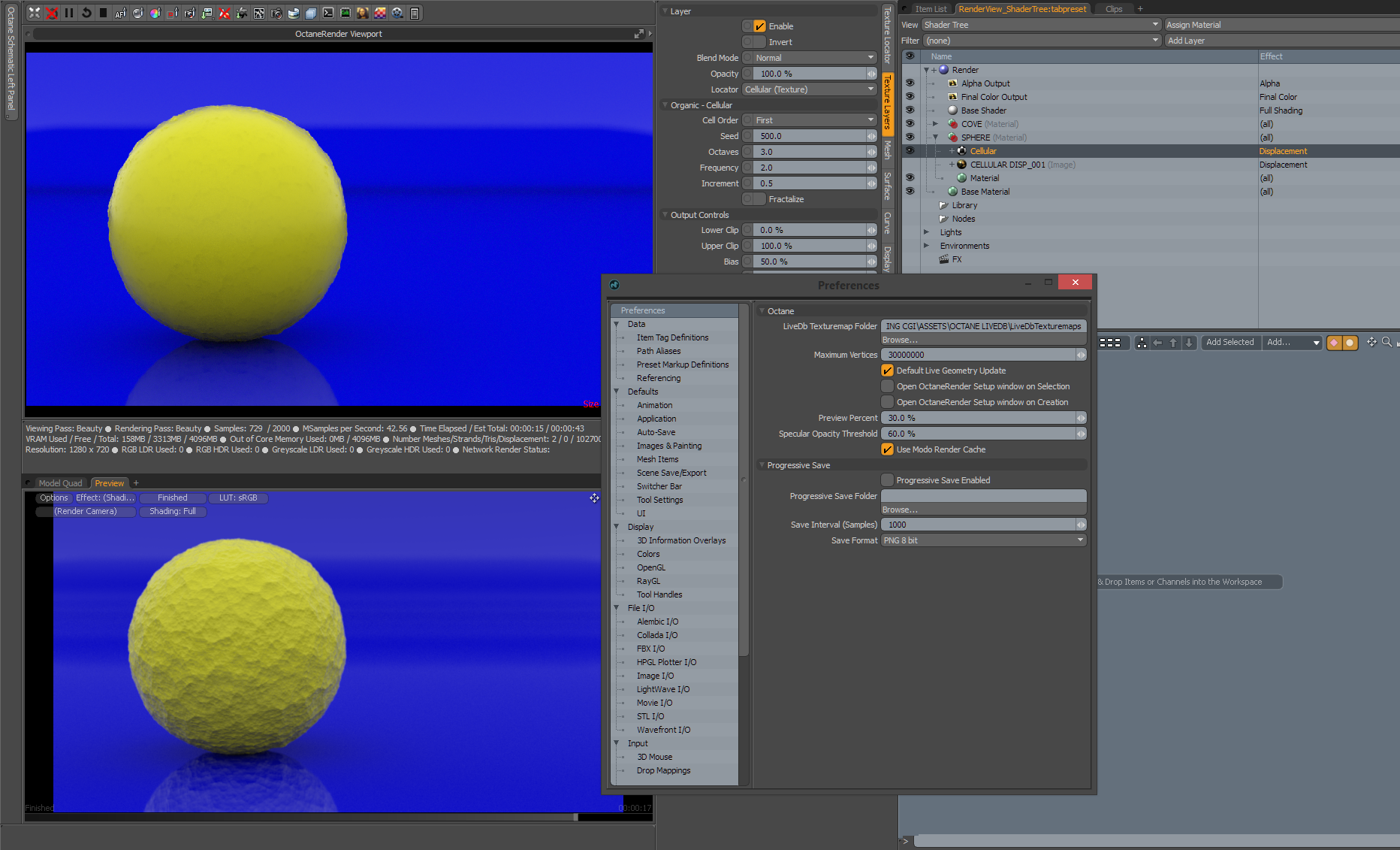

FOLLOW UP: I just ran some tests again and when 'use modo render cache' is active and 'Polygon Displacement' is active, things seem to break. I've included another screen capture of what I'm seeing. Again, if I deactivate 'use modo render cache' and 'polygon displacement' is also off, then displacement seems to work just fine in the Octane Preview and the displacement updates automatically when I adjust the material's displacement setting. Also, when you hover over 'use modo render cache' in the Octane preferences panel, it seems that the primary reason to use this is so that you can use Modo's procedural textures. Whenever I've tried this I get the same displacement abnormalities as seen in this screen capture as well as those seen in many of the other screen captures posted. The displacement seems stunted somehow.

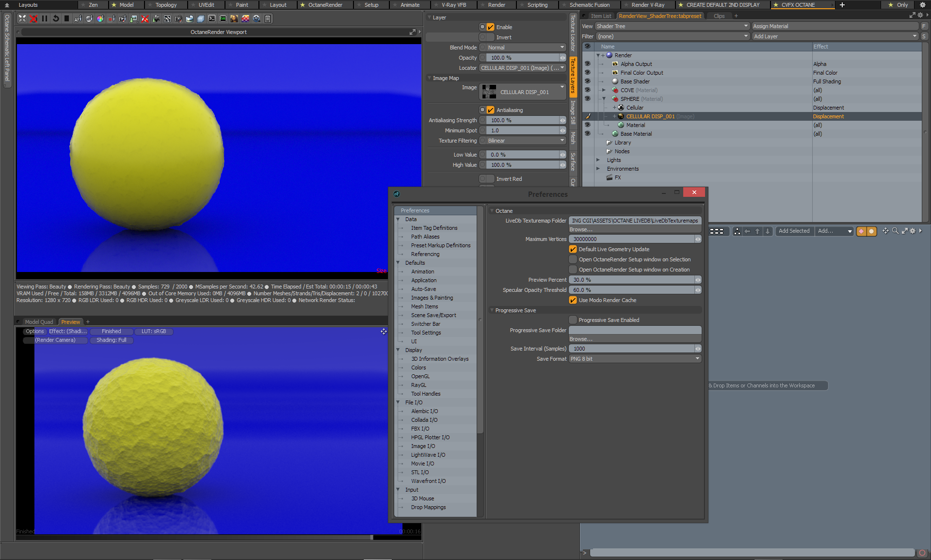

Again, I have to disagree here. I'm seeing very strange results (as I've been saying since the beginning of this thread). I have attached another two screen captures illustrating the point. One uses the baked version of the procedural noise layer and the second uses the actual procedural noise layer. The stunted displacement occurs in both, even when the Octane preview is stopped and restarted. 'Use modo render cache' is enabled. 'Polygon Displacement' is enabled.
I have included a download link of the original Modo scene file - https://www.dropbox.com/s/giesd0xspz22j ... l.lxo?dl=0
