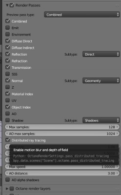

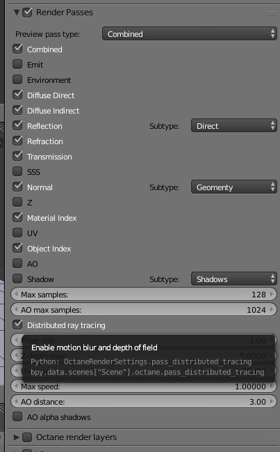

hi pegot, you still probably need to enable "Distributed ray tracing" in the passes node of the blender plugin:
This is also mentioned in standalone edition viewtopic.php?f=33&t=43126&start=3
