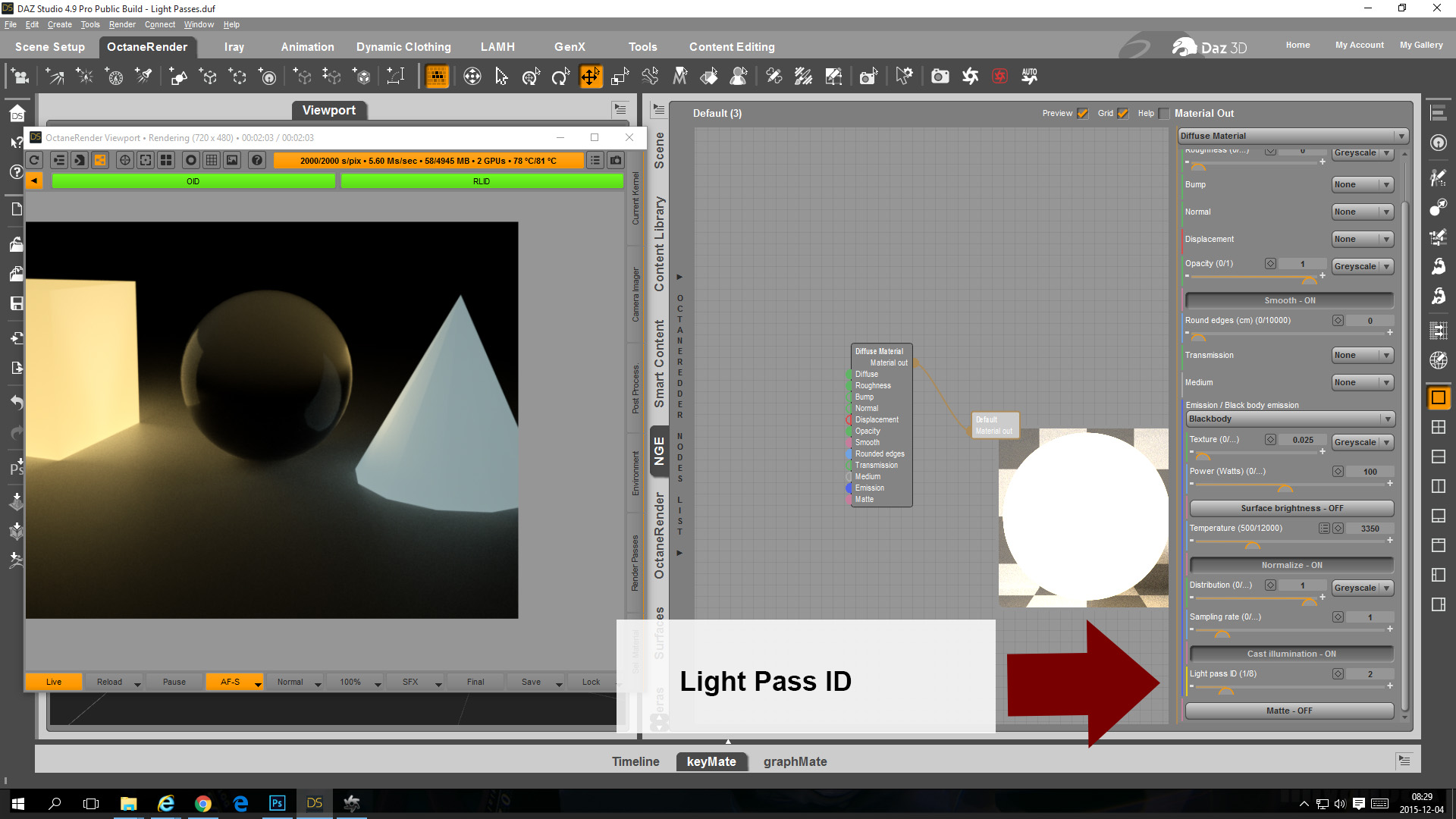

You set the Light Pass ID in the Emission options of your light emitting diffuse material.
By default all lights are added to Light Pass ID 1.
You can manually assign lights to other Light Pass IDs to render them out on a separate layer.
There are two lights in the scene.<br />The cone is added by default to light pass ID 1.<br />The cube is assigned manually to Light Pass ID 2.

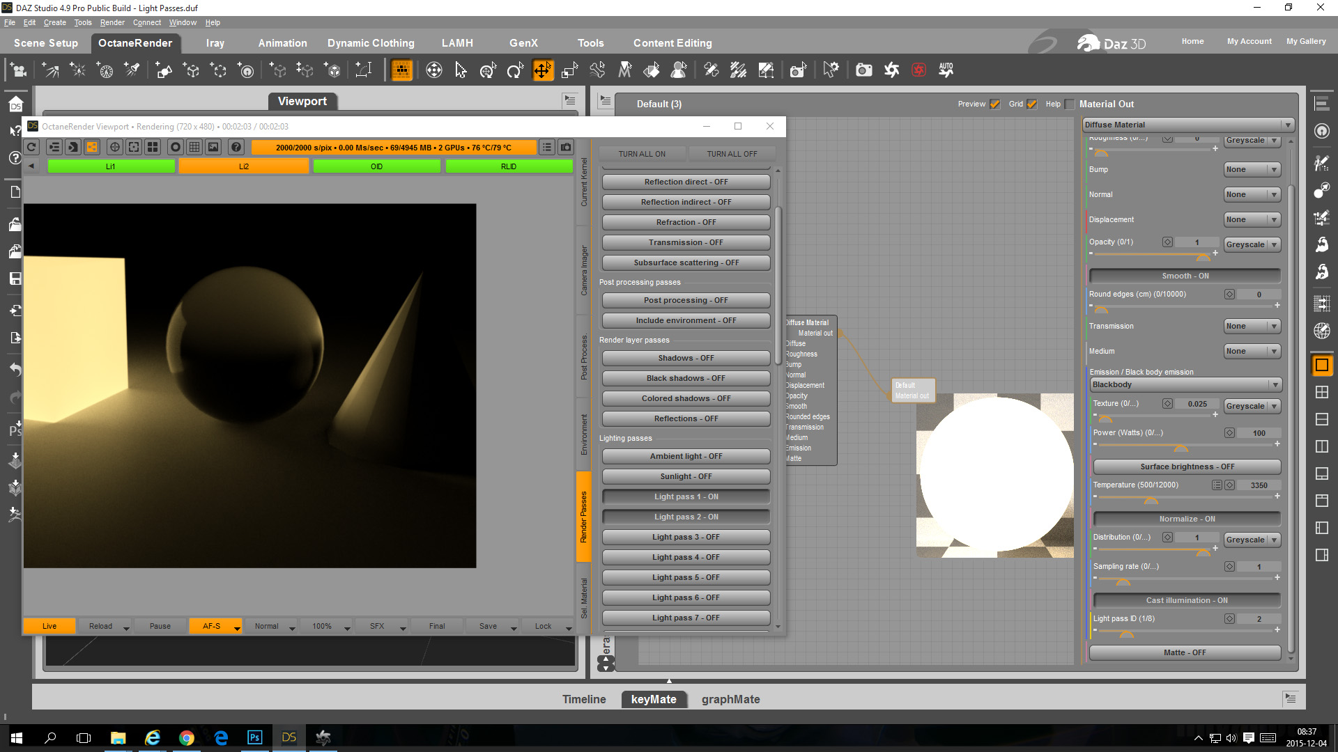

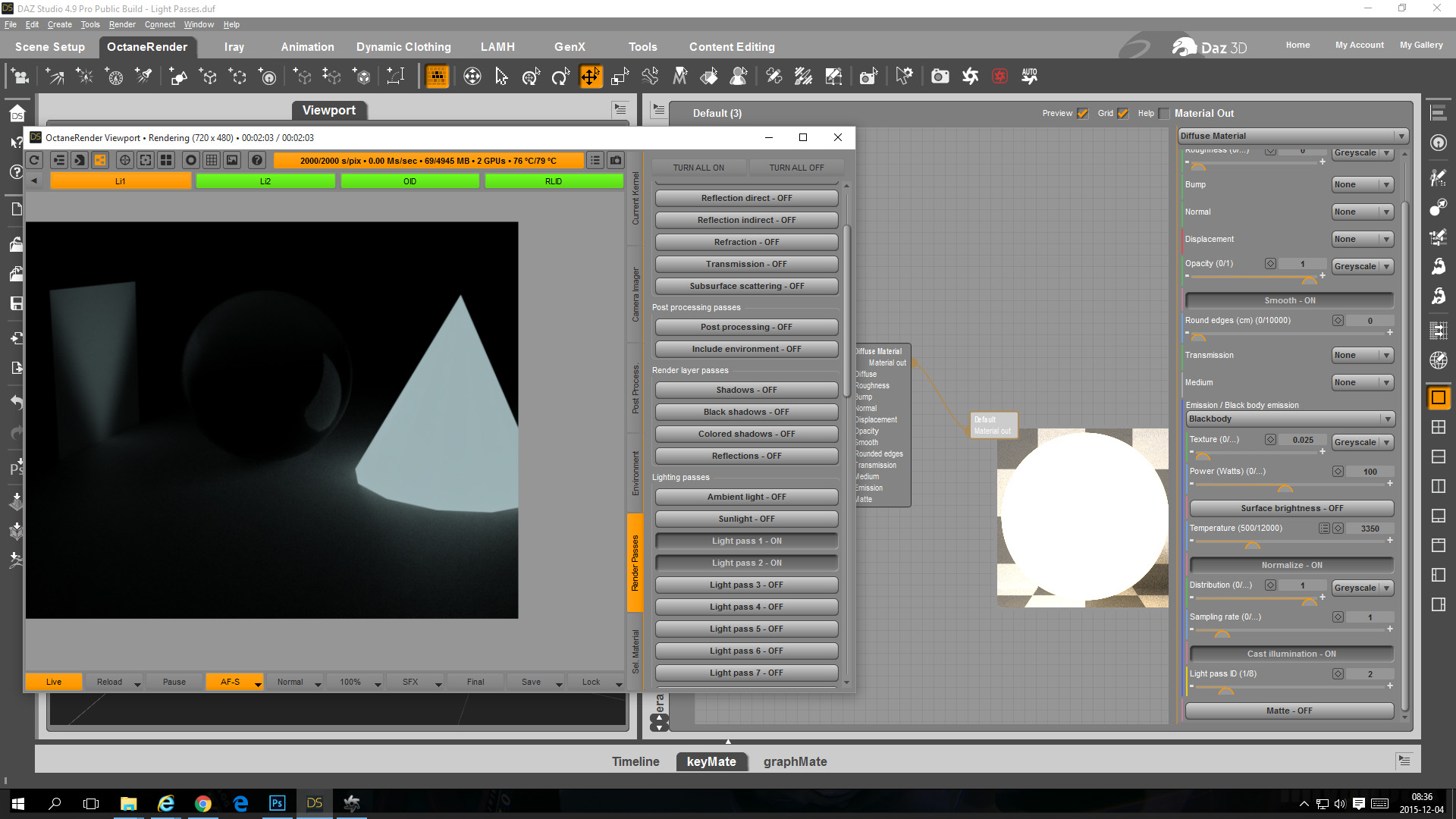

You can preview how each light pass looks like by clicking on the green L1 - L2 button on top of the OcDS viewport. In general all activated render passes are rendered simultaneously.
Both Light Pass 1 and Light Pass 2 are toggled ON<br />Light Pass 1 (L1) is selected
Both Light Pass 1 and Light Pass 2 are toggled ON<br />Light Pass 2 (L2) is selected

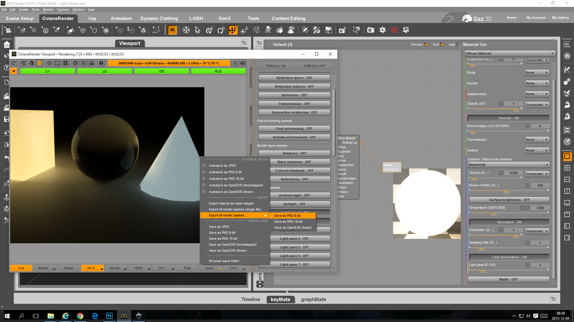

Export all your selected render passes

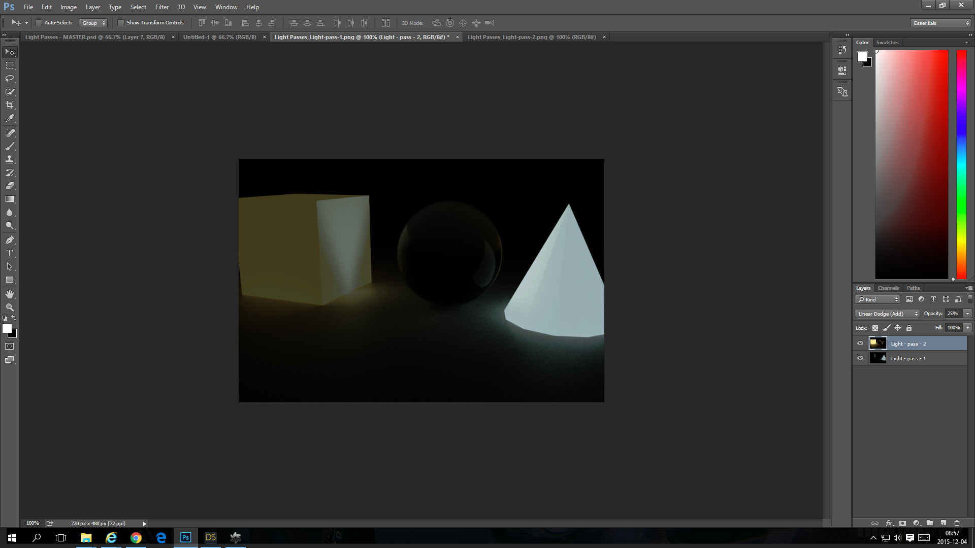

Composite your render passes in photshop with layer mode "Linear Dodge - Add"
The cool thing about rendering out Light passes is that you can change how strong each light should affect the scene AFTER you finished rendering by adjusting light strength in post production.
In this example the Light Pass 2 was dimmed down by reducing the layer opacity in photoshop down to 25%.
Of course you can also use masks in photoshop to get more control which areas of the image should receive more or less light.
