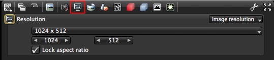

You can change the viewport size in the Resolution pin of any Render Target node with presets and aspect ratio check box.

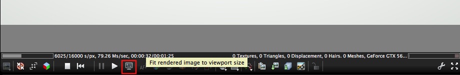

If the viewport doesn't update, probably you have the "Fit rendered image to viewport size" option active in the viewport info bar :roll:

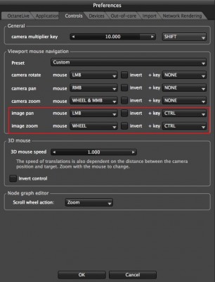

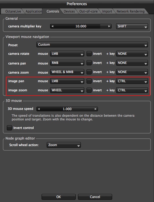

you can zoom in and out the viewport with ctrl + mouse wheel without changing the final resolution. At 3500x3500 there could be a bit of lag because of the big frame buffer, but I have just tested it and I can zoom in and out smoothly here :roll:
