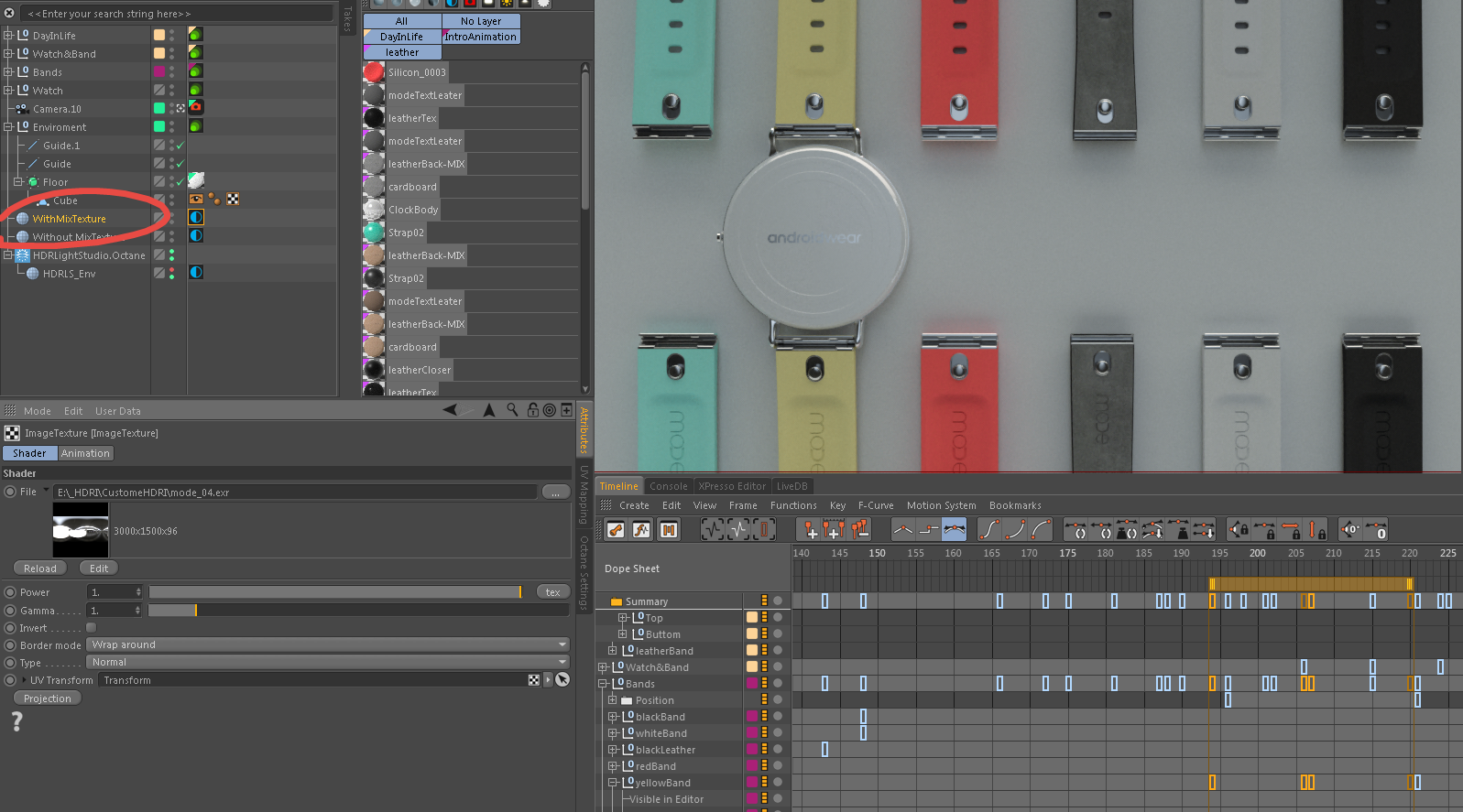

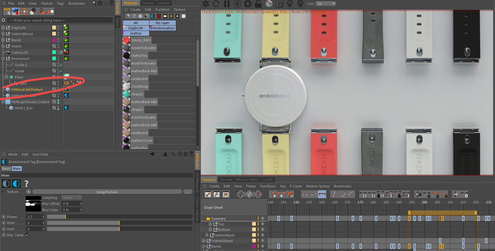

Hi All,
I need to do a transition between 2 HDRI's and i cant get an accurate result. (it's not a rotation issue, I know plugin internally creates a transform when you have just an image texture so transform node with the right transformation is applied). Everytime i'm trying to put the HDRI inside MIX Texture something is messed out. Seems like a gamma issue, but any gamma change (0.4545) not solving that. I just can't reach the same looks with the HDRI inside a MIX Texture.
I can swear i'm doing everything right but this really ruining a deadline i need to hit :/ so any help will be awesome right now.
I've uploaded a simple scene, and some screenshot. What the hell am i missing?
Thanks!

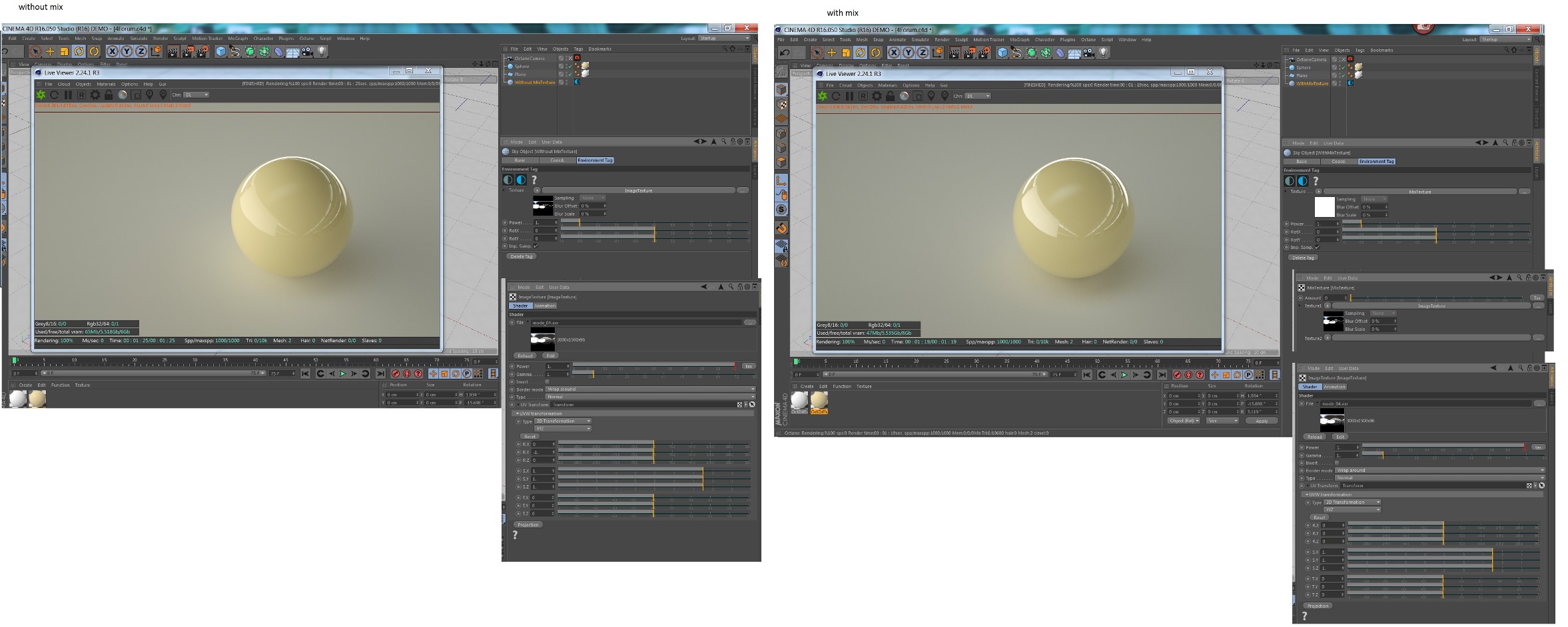

Hi Yambo, you may be right. currently the closest I could get:
still trying out some more with other settings.

Thank you for the comment - In this 'sphere scene' the difference is not that noticeable but in a complex scene there is a major difference. I spent many hours trying all the possible settings and nothing worked.

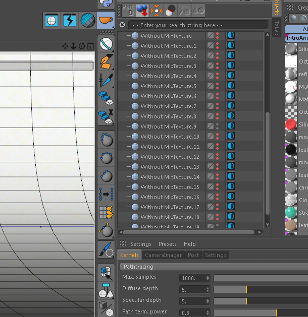

I talked to Ahmet regarding this issue and he told me he is a bit busy for that right now so i left it - But it's a major issue for me, I did a crazy workaround - exporting EXR sequance of the HDRI's from AE and animated the visibility of each HDRI environment (image attached) instead of just animation the MIX slider.
Hope you'll address this issue soon
