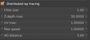

Okay I checked again and somehow it seems like the Z pass works, now I double checked with previous versions of my scene, the only thing I changed was enabling "Distributed ray tracing"
and I couldn't see in the manual any mention of it, what does it do?
2015-12-02 00_33_33-Blender_ [D__WORK_photoshop files_the icy_passage_the icy passage_v004.blend].jpg
2015-12-02 00_33_33-Blender_ [D__WORK_photoshop files_the icy_passage_the icy passage_v004.blend].jpg (19.11 KiB) Viewed 3298 times
