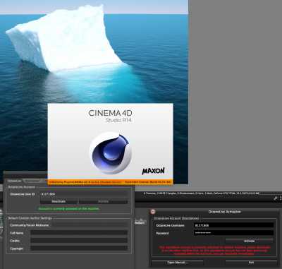

Perhaps I am doing this wrong... here are my steps...
I deactivate both my stand alone and my cinema4d plugin (wait an hour if needed) then first re-activate the stand alone... I was succesful.
Then activate the plugin... also succesful.
Rendered away and quit ... no problem
Re Opened Cin. and I get a message saying the standalone account is currently activated in another machine etc...
I have two stand alone accounts so if I deactivate stand alone 1 and use 2 I am good to go until I quit and reopen again... it gives the same message.
Am I doing something incorrectly???
The image attached shows the error I get upon starting Cin R14 the second time... the background shows the standalone succ loaded and rendering using the same number. (It can't be on another machine or it would not work on this one)

This can be caused by switching between different versions of OctaneRender, please ensure that your Standalone and Plugin(s) are running the same version of the OctaneRender engine. (i.e. 2.24.2)

Thanks I'll double check
