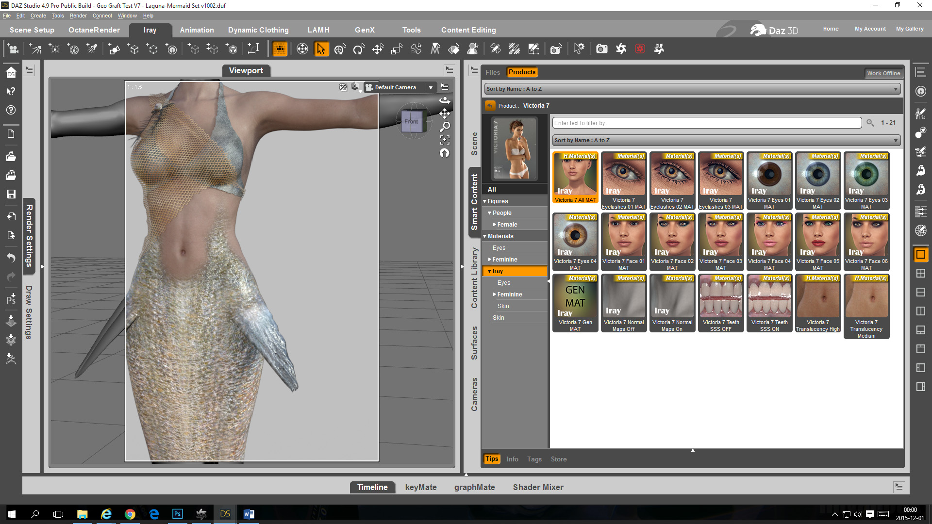

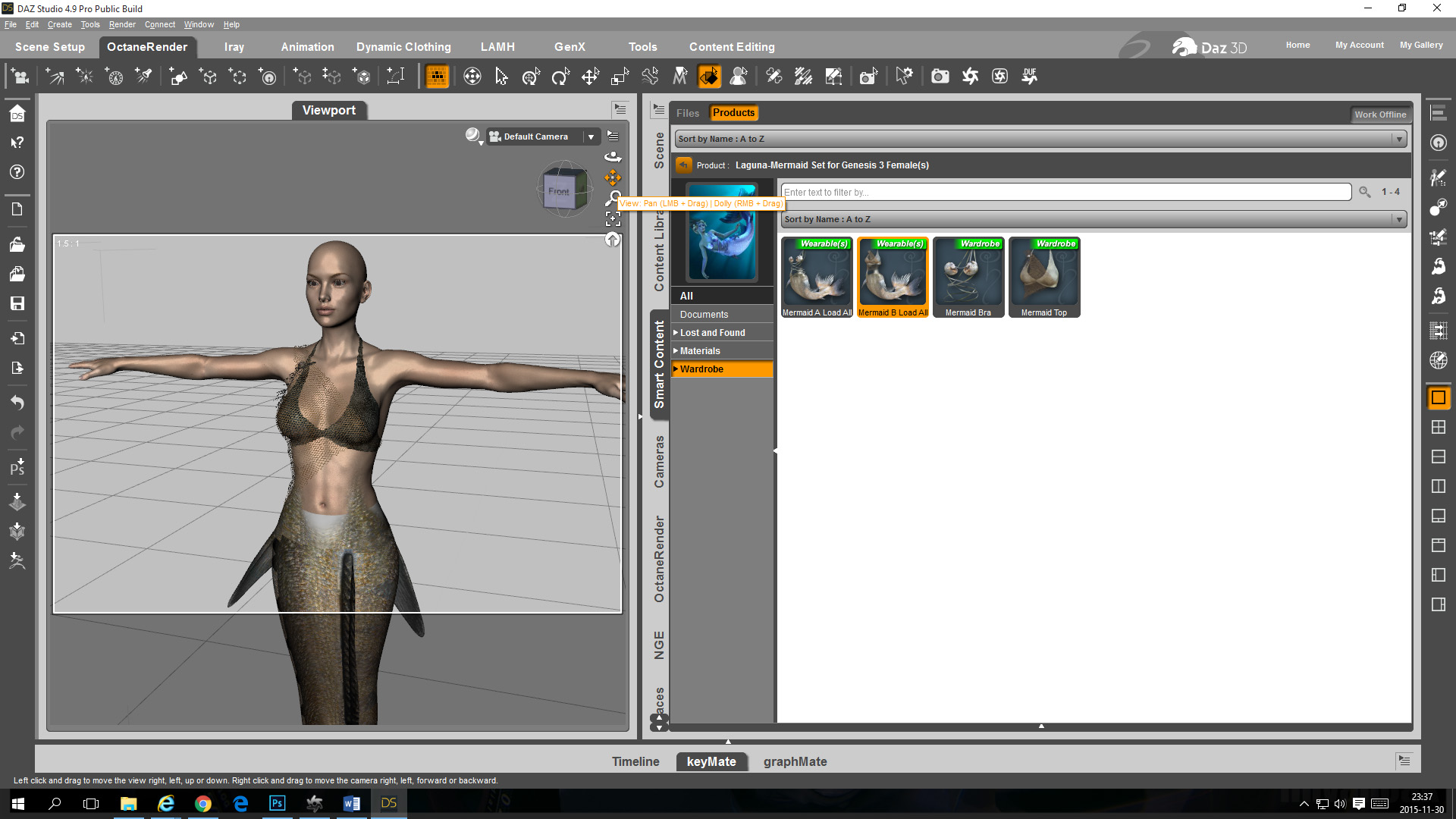

If you follow this simple workflow you manage to make Geo Grafts and Geometry shells look properly in the OpenGL viewport and Iray and may be able to reproduce two issues in OcDS:
1) place Victoria 7 in the scene
2) type laguna in the Smart content tab to find the product "Laguna-Mermaid Set for Genesis 3 Female"
3) apply wardrobe preset "Mermaid B Load All"
You will notice that there is a gray area in the torso surface zone.
Currently in the DAZ Studio Iray version there are now three layers of surface zones:
- Geometry Shell of the Mermaid Tail "Torso" surface (opacity map for the tail material)
- Mermaid Tail "Torso" surface (gray area)
- Genesis 3 female "Torso" surface (the surface part that is overlapping with the Geograft is hidden in DAZ Studio by default)
To fix this we manually apply the V7 material to the torso surface zone of the mermaid tail.
4) Apply the "V7 All Mat" to Mermaid Tail Torso surface
Now the gray area is gone and both V7 and the mermaid tail render properly in Iray.

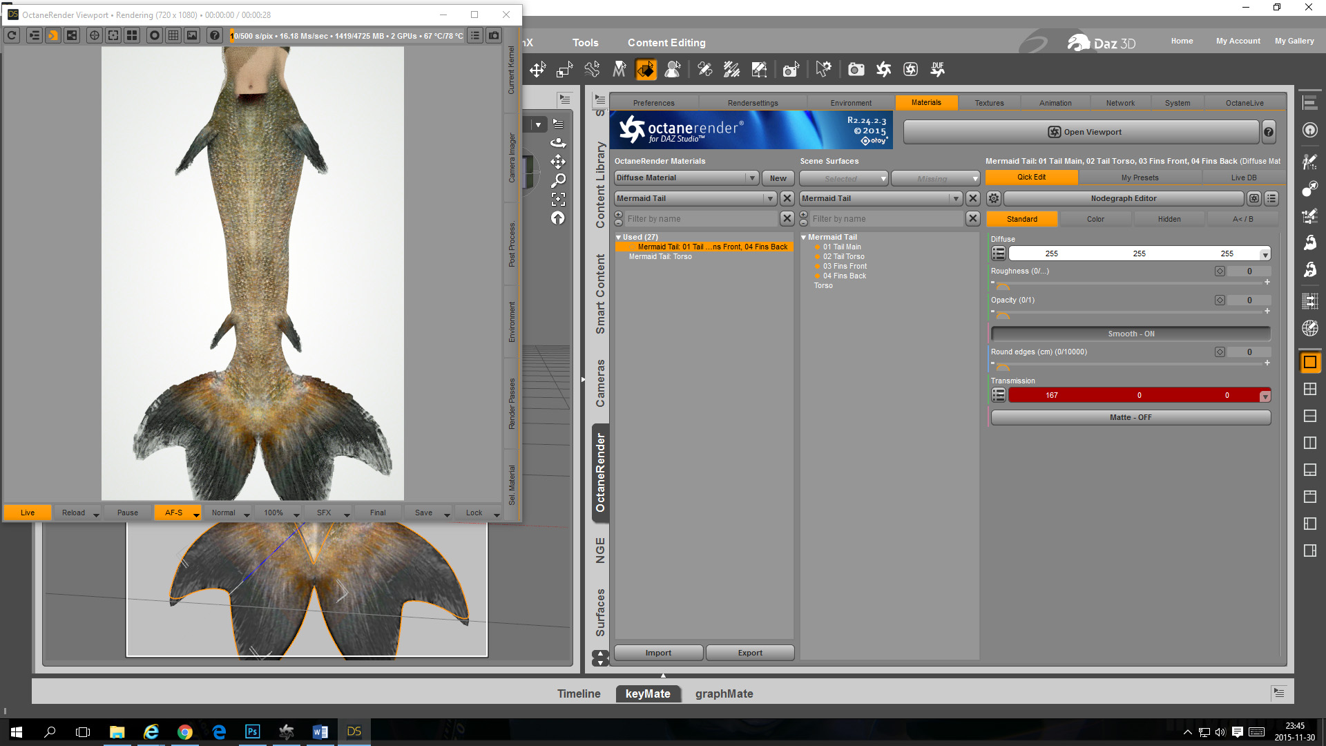

5) Trigger the OR auto conversion
Now you may be able to detect two separate issues:
- The mermaid tail surface is overlapping with the Mermaid Geometry Shell surfaces

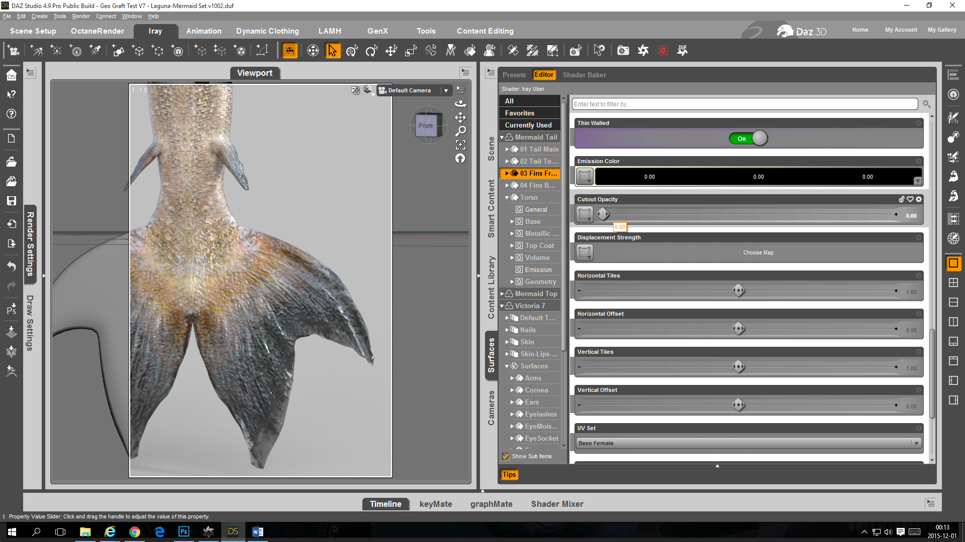

Issue: It seems the Iray Cutout Opacity was not properly auto converted to OR.
For now we can fix this manually.

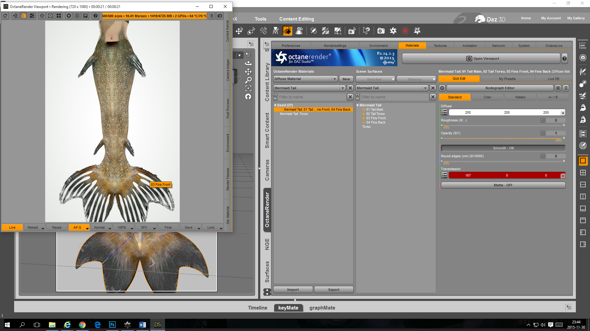

Since the Mermaid Tail Geometry Shell is on top of the Mermaid Tail we can simply hide the unwanted mermaid tail surfaces.
This area is now fixed in OR as well.

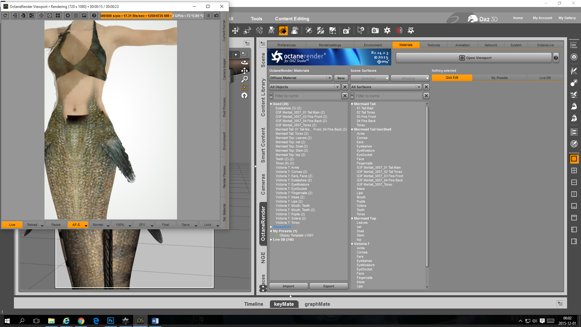

The remaining issue as described at the start of this post is:
Hidden areas on the bottom surface layer cause surface layers on top also to be hidden when three surface zones are stacked on each other
You can observe a black hole in the area where the three surface layers are stacked.
My guess is that the hidden faces of the Victoria 7 torso surface zone where the mermaid tail Geo Graft is attached somehow interact with the mermaid tail torso and the mermaid tail geometry torso surface zones.

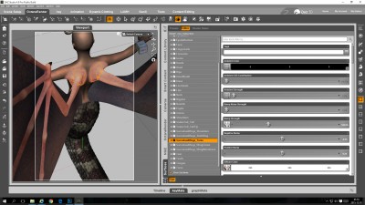

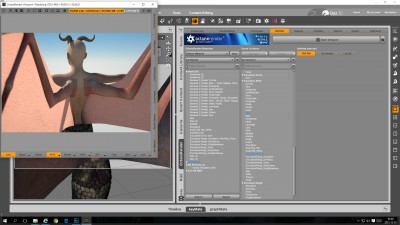

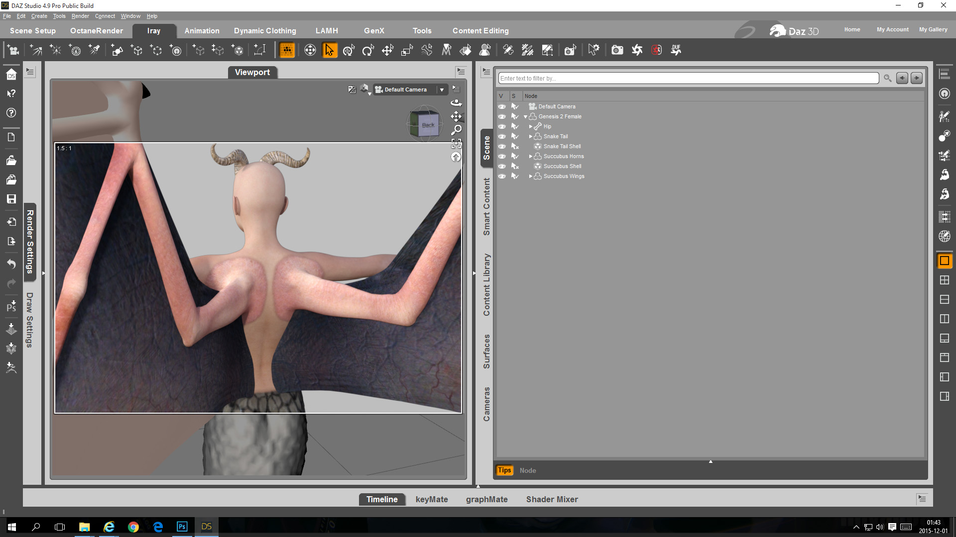

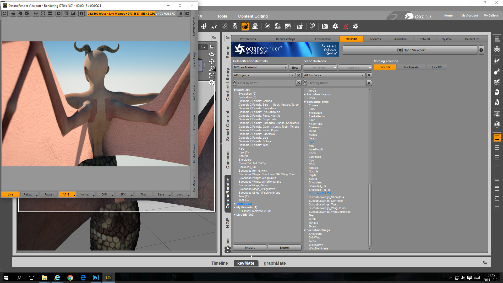

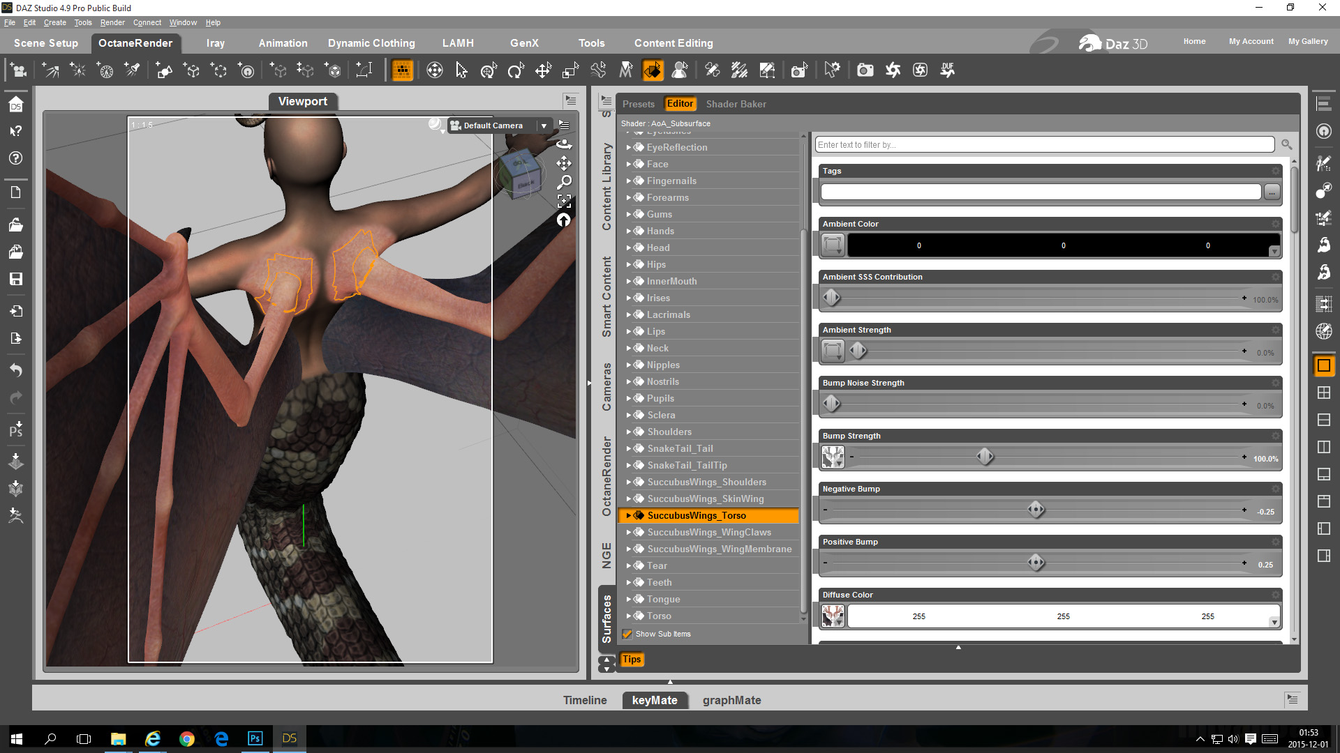

Test 4 - Genesis 2 female with tail, horns, wings Geo Graft
http://www.daz3d.com/succubus-add-ons
Succubus Add-Ons Iray
G2F Succubus Add-Ons OR Auto Conversion
Geometry Shell Succubus Wings
Instead of a smooth transition between the figure and the Geo Graft as in Iray there is a hard edge border visible in OctaneRender.
In this example there are again three layers including Geometry Shells that yield weird results in OR.
Subjective Speculation:
It could be that the underlying reason for issues with Geo Grafts is that the order of the surface layers is messed up when reading them in to OctaneRender because the hidden "facets" on the parent figure interfere in some way with the surface order.
In Iray and 3Delight it may be:
top: Geometry Shell
middle: Geo Graft
bottom: Parent Figure
In OctaneRender it may be
top 1: Parent figure (only in those areas where the connecting "facets" are)
top 2: Geometry Shell
middle: Geo Graft
bottom: Parent figure
