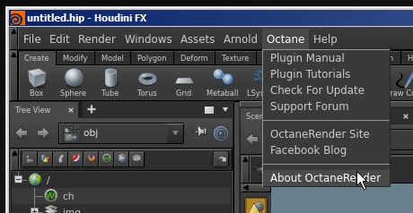

Do you get any error? ... You should have at least an Octane menu entry in the main menu bar.
-Juanjo

yes i have all of this, but i can't open.. i have an error message.
whe i clic on a menu, i have:
the attenpted operation failed
Invalid node type name
show détails:
Traceback (most recent call last):
File "Add_Octane_ROP", line 1, in <module>
File "C:/PROGRA~1/SIDEEF~1/HOUDIN~1.16/houdini/python2.7libs\roptoolutils.py", line 9, in createRenderNode
rop = hou.node('/out').createNode(rop_type, exact_type_name=True)
File "C:/PROGRA~1/SIDEEF~1/HOUDIN~1.16/houdini/python2.7libs\hou.py", line 5279, in createNode
return _hou.Node_createNode(*args, **kwargs)
OperationFailed: The attempted operation failed.
