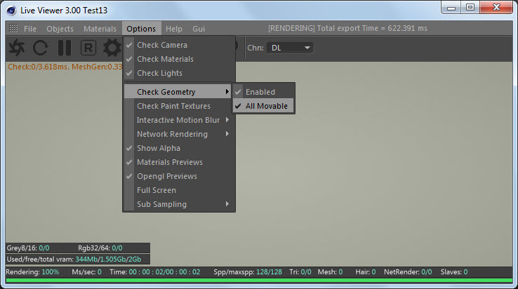

Have you checked free VRAM and total triangle counts in LV and PV's info lines?

I will check, but where is and what is LV and PV's info lines?

As in image. Also Picture Viewer display a line at bottom for similar info. You can check manual or tutorials for extra information about LV.

From picture viewer:
From Live Viewer Window:
I use 2xGTX780Ti and one GTX690 (so in octane gpu0: 780ti, gpu1: 780ti, gpu2: 690, gup3: 690).
