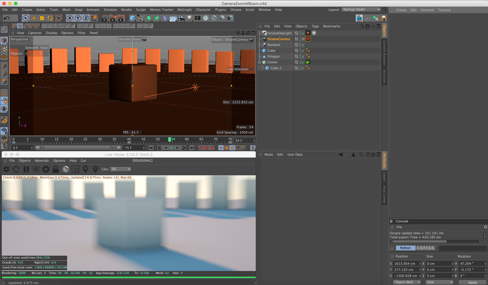

if your are referring to the Camera MB, a position transformation is needed.
here is a test by adding a bit of movement to the camera to introduce the MB:
CameraZoomMBcam.c4d.zip
(62 KiB) Downloaded 189 times

thanks beppe, but what I was talking about was strictly motion blur that comes from changing focal length / zooming. So movement of camera doesn't have anything to do with this. So imagine having a still cam that quickly zooms in or out of something
I just found this thread which proves this is not implemented yet - viewtopic.php?f=30&t=46615
